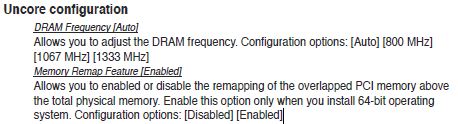

As I've said, I see nothing like that in the BIOS. It's a very basic motherboard.
I see no way to adjust RAM timings and even if I could, I would never have touched them.

does this help you at all? i pulled this information about the BIOS from the motherboard's manual
The only BIOS screen I can find related to RAM is this one, and it's all set to Auto:
