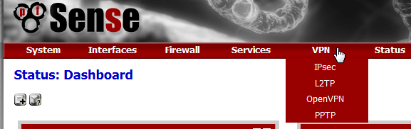

Yeah what do you want to use pptp, ipsec, l2tp or openvpn - those are the 4 out of the box that you click and setup.
I would suggest openvpn, it runs on 1 port - which can be set to say 443 if need be - this port is normally always open no matter where you located. I use this pretty much daily to get into my network from work.

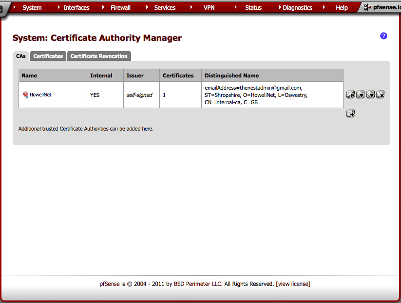

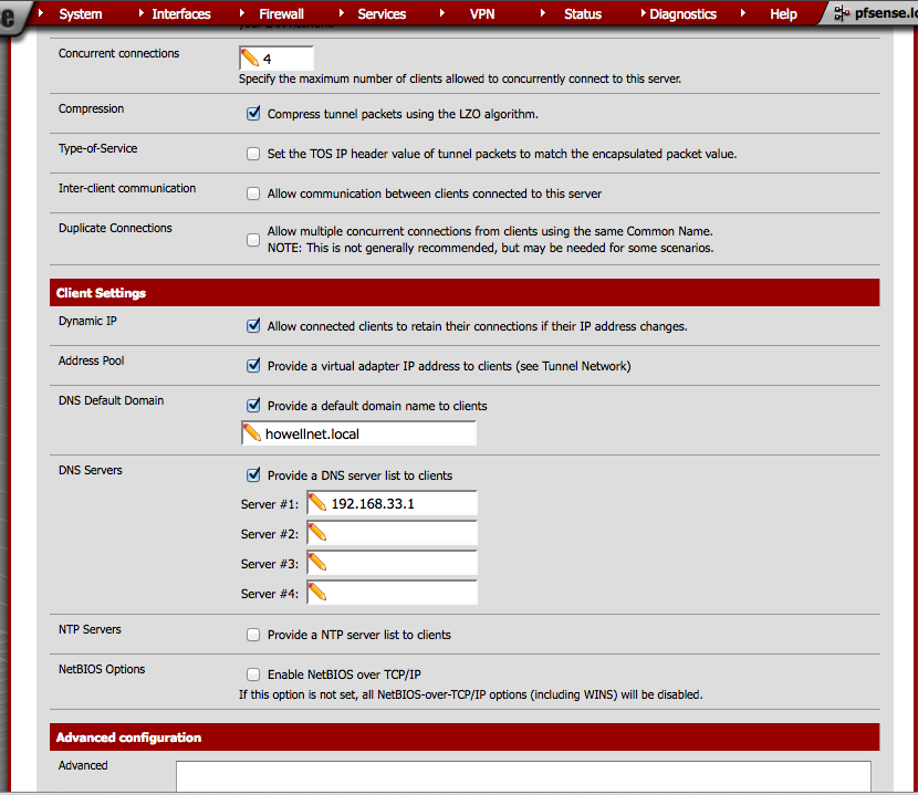

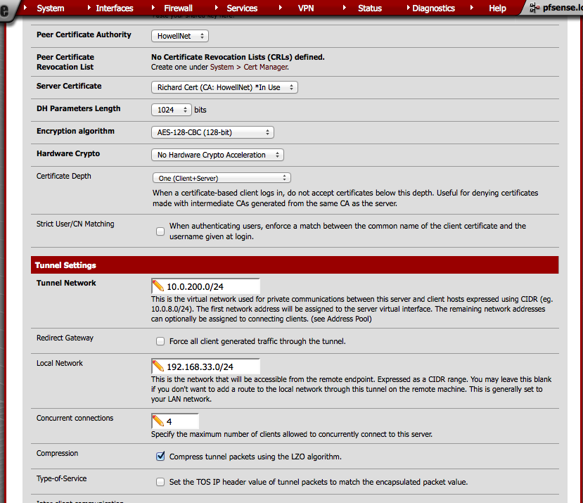

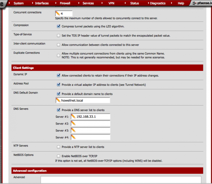

Budman, is that the only page that i need to fill in? I have been reading guides online that mention generating Certificates and Adding users etc then exporting bits and bobs to import into your client.

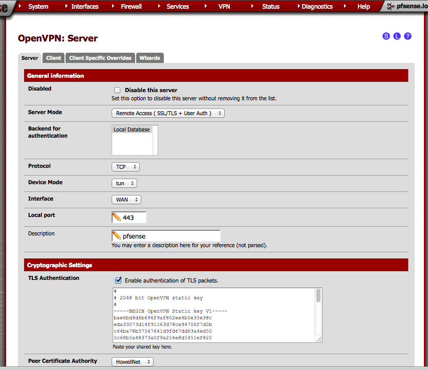

Thanks for that thought answers some of my questions :) What is that TLS Auth box, where did you get the data to go into there?

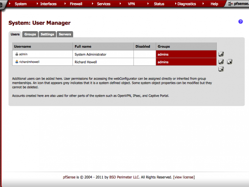

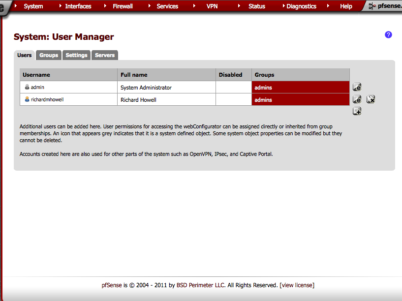

yes you have to create a cert for the user, under usermanager - well to be honest you don't you could setup your open as user auth, or peer to peer shared key. But I would suggest creating cert.

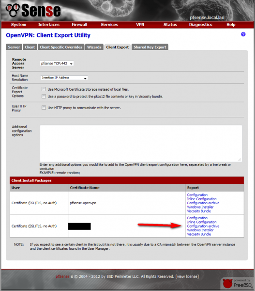

As to what to export for the user, grab the "OpenVPN Client Export Utility" package

As to "Enable authentication of TLS packets. " It will create that cert for you once you click the box.
that is a CA your showing not a certificate, the user your logging in with should have a cert. But my quick looks and should work, you don't have netbios enabled so you want be able to broadcast for names. But should be able to get logged in, if you have a cert on the user account signed by your CA.
Your also asking for userauth, which I personally don't see the need for - user has to have the CERT to login, but sure you can also ask for password. I just think its more overhead for no real reason. Only person that would have my cert is ME, and if I lost it I would just revoke it, etc.
that is a CA your showing not a certificate, the user your logging in with should have a cert. But my quick looks and should work, you don't have netbios enabled so you want be able to broadcast for names. But should be able to get logged in, if you have a cert on the user account signed by your CA. Your also asking for userauth, which I personally don't see the need for - user has to have the CERT to login, but sure you can also ask for password. I just think its more overhead for no real reason. Only person that would have my cert is ME, and if I lost it I would just revoke it, etc.

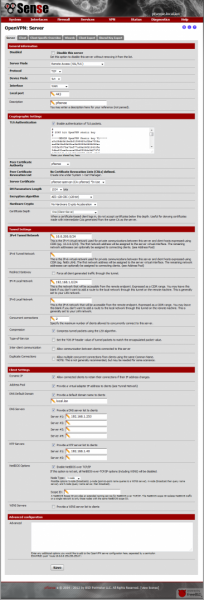

What settings should i change then to set this up properly?

Are you sure your putting in the correct username and password? That you setup for your account your wanting to use for access. Did you install the export package - what are you grabbing? It would not list your user for export if you don't have a cert on the account.

You say your on a mac right? Are you using http://www.thesparklabs.com/viscosity/ as your client, did you download the viscosity bundle from the export package?

I set it to just tls vs + userauth.. You can set it back if you want. I just didn't want to have to deal with username/password.
There is no way you were ever getting asked for auth, that must of been just teh setting in the client. Your firewall rule was for udp 1194, the default openvpn port. I changed it to your setting of 443 tcp. Popped right in!
