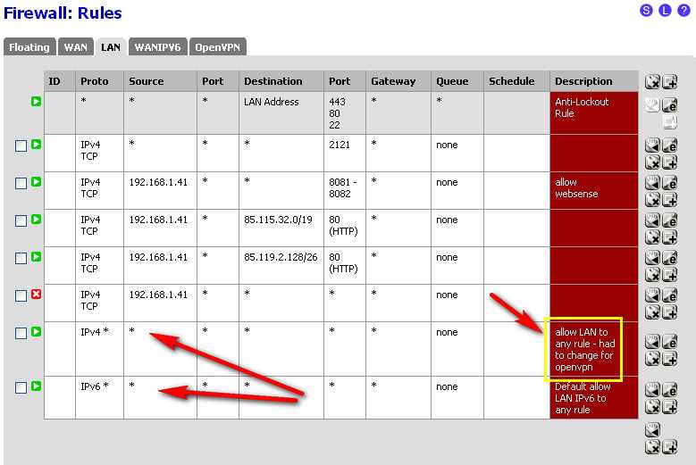

are you running host firewalls on your other devices? if so you would have to allow traffic on the ports you want from the 10.0.200 network. Also I have changed my pfsense lan rule to be any vs lan net. I was having issues doing something, which I don't recall exactly what now with vpn clients, and changing it to any for the lan interface rules fixed it.
See my note and how the lan source is * vs lan net, I don't recall exactly why now though. Something was not working, I would have to set it back to see what doesn't work to refresh my memory. But I do recall changing source for something I was trying to do - which now works, just don't recall what it was ;)

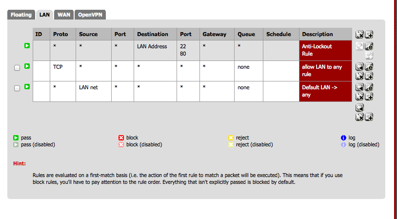

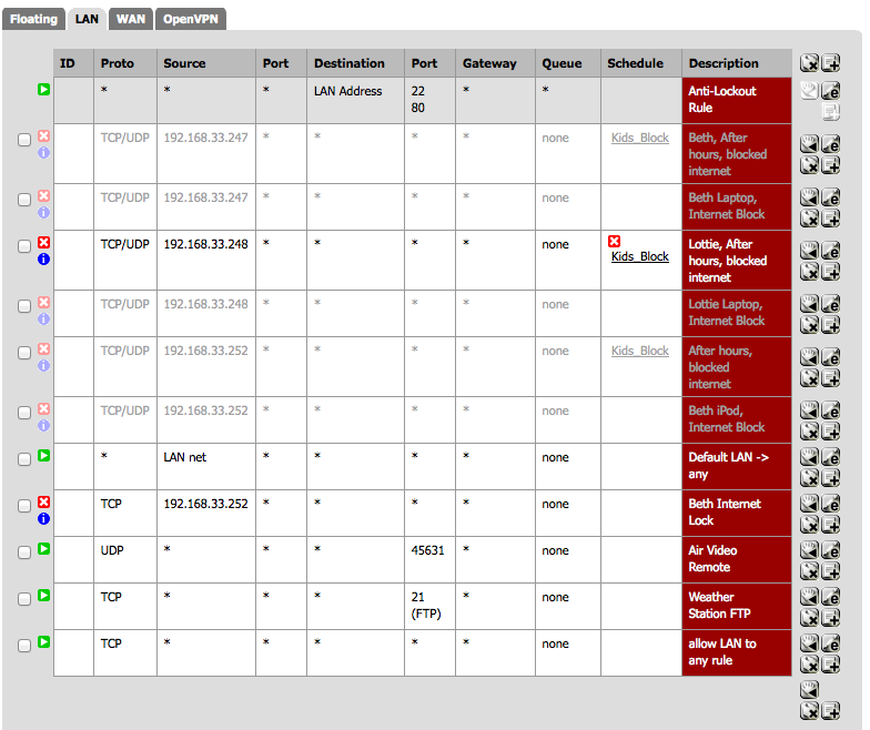

Im running ipv6, those that breaks it up.. Se your rule above your block from source 192.168.33.252, that is your lan allow.
I don't see how that block is working though? because 192.168.33.252 falls into your lan net, and would be allowed access before it hits the block. If you want to block that IP from using the internet on tcp, then you need to put that above your lan net rule.
And you really have duplicate rules there, one with lan net as source (which is your 192.168.33.0/24) and then that last rule which is any any. And your rules for 45631 and 21 are also not needed since they would fall under that lan net rule. Unless they were coming from different network than your lan net?
Rules go down in order from top, first rule that hits is one that is applied - be it allowed or blocked. Notice in my lan rules the ones for .41 address - I allow it access only to the websense stuff, then I block its access for anything else! So if say .23 comes it, he goes past all those rules until he hits my allow rule.
Again, not sure why you have 2 rules there
Unless you have something with UDP going on, you let anything out TCP. Then next rule is anything *, so that would include tcp and udp coming from your lan net can go anywhere.
You really only need one rule, not now sure on the details - but like I said for something I was trying to do with vpn, I changed the default rule from lan net to *, which kind of like the rule you have above the lan net rule, only you change proto to TCP only - not sure why?

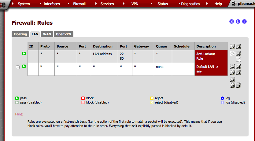

I have removed this, see my updated post below.
I know what had happened here, when i was reading your rules table i saw that it said IPV4* i got confused and thought that this was something that it wasn't, it wasn't until later that i found out you were running IPV6 that is why you got them options. I now notice that the IPV4 on my setup is just * as i am not running IPV6.
