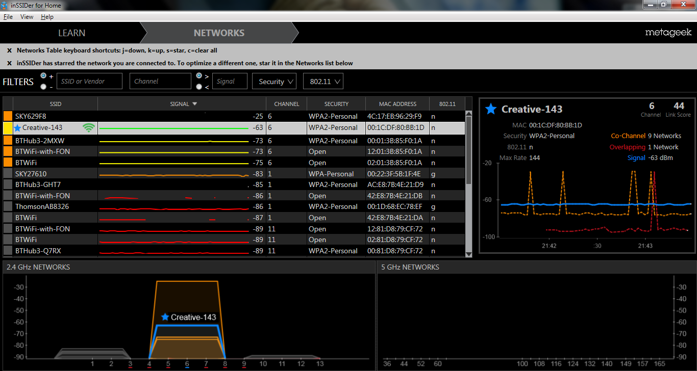

Also that screenshot looks to me like you have 3 wireless networks all on channel 6, they're all definitely going to interfere with each other, so change the channel on the one you want to use.
Channel 11 is usually one to avoid as it's the default on a lot of routers.

My inSSIDer:

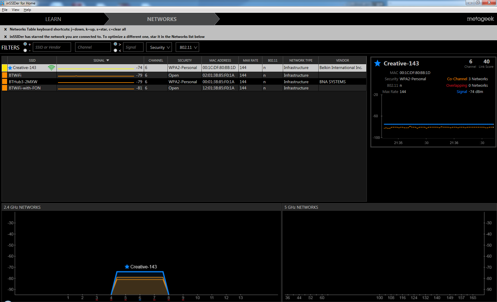

Partner's inSSIDer (remember, we're in the same room):

Again, that new screenshot is showing loads of WiFi networks all using just 3 channels, change your channel first!! Anything apart from 1, 6 or 11 (although it looks like that list shows more than your screenshot so, obviously, avoid any other duplicated channels). There are tons of apps you can get for either iOS or Android which will let you test the WiFi strength of each channel, try using one of these to see which channel will give you the best signal.
It tells you all this on the inSSIDer site :
Pick a Better Channel for Your Wi-Fi
All Wi-Fi must share channels with other networks in the environment. Too many networks sharing or overlapping a channel can slow down the performance of all Wi-Fi networks on that channel. This Wi-Fi scanner helps you see the best channel for your Wi-Fi.
Curious why your not seeing that sky SSID that is HUGE signal compared to the creative-143 your trying to connect too? On the other listing.. That makes no sense - and clearly would be stomping all over your signal on that channel.
If you do not have access to the router, there is NO way for you to change the channel. But channel 6 is in heavy use.. I am at a loss to why your not seeing the sky629f8 SSID? is that a ad-hoc network? And your filtering those out? Can not see from the other listing if its inf or adhoc. But that signal clearly would be not good for your signal.. Move over to 1 or 11, those seem much lower - I don't recall if you have access to the router gui or not?

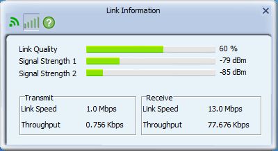

If you notice your transmit your at 1mbps -- that is going to blow.. And then your download your only at 13.. Again that blows for even a G signal.

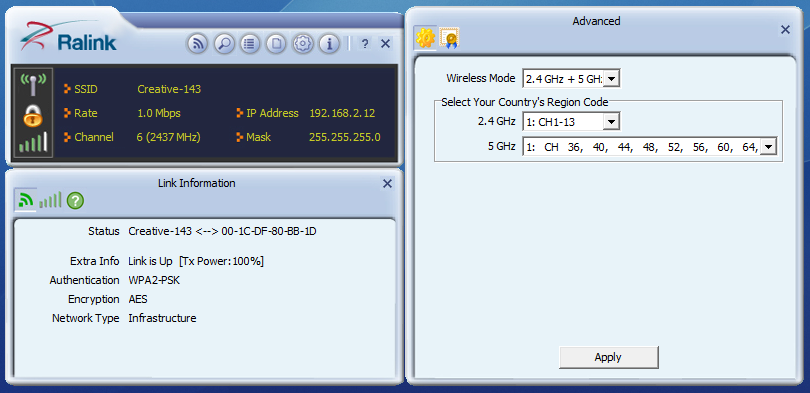

No idea what type of network it is.
I have changed the channel to 2, 4, 8 and 10 on the router (via. 182.168.2.1), I think they all may make it worse :(
The program was not filtering.
When I took the two screenshots, the PC was in the same location as the laptop, which makes it more confusing.

Since you have access to the router - change the channel to 1 or 11, and try doing something other than wpa2 aes, try wpa1 (tkip) try it open.. How is the speed then?
I would recommend using the wifi software in windows to connect to the network and not that crappy 3rd party software.
I don't use that software. It was just providing information.
I have used three network cards - so obviously that software I wasn't using that software (since it only works with one of the three pieces of hardware).

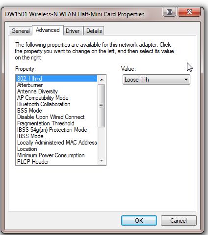

I would also post up your wireless nic settings from the adapter.
example
Off the top, I don't recall a way to easy export these.. I recall a blog post complaining about not easy to work with powershell with advanced nic settings and that in 2012 and w8 it was suppose to be easier. But have not looked into as of yet. But I think your currently running win7?
If after your new ant that sky ssid does not show up, then we need to figure out if its adhoc or not, see the column on your buddies printout showing the type.. Where is that for yours and that network, or show it on his for that network. Guess you might have setup your nic to only see infrastructure type, etc. But that can be miss leading for noise in the area, etc.
