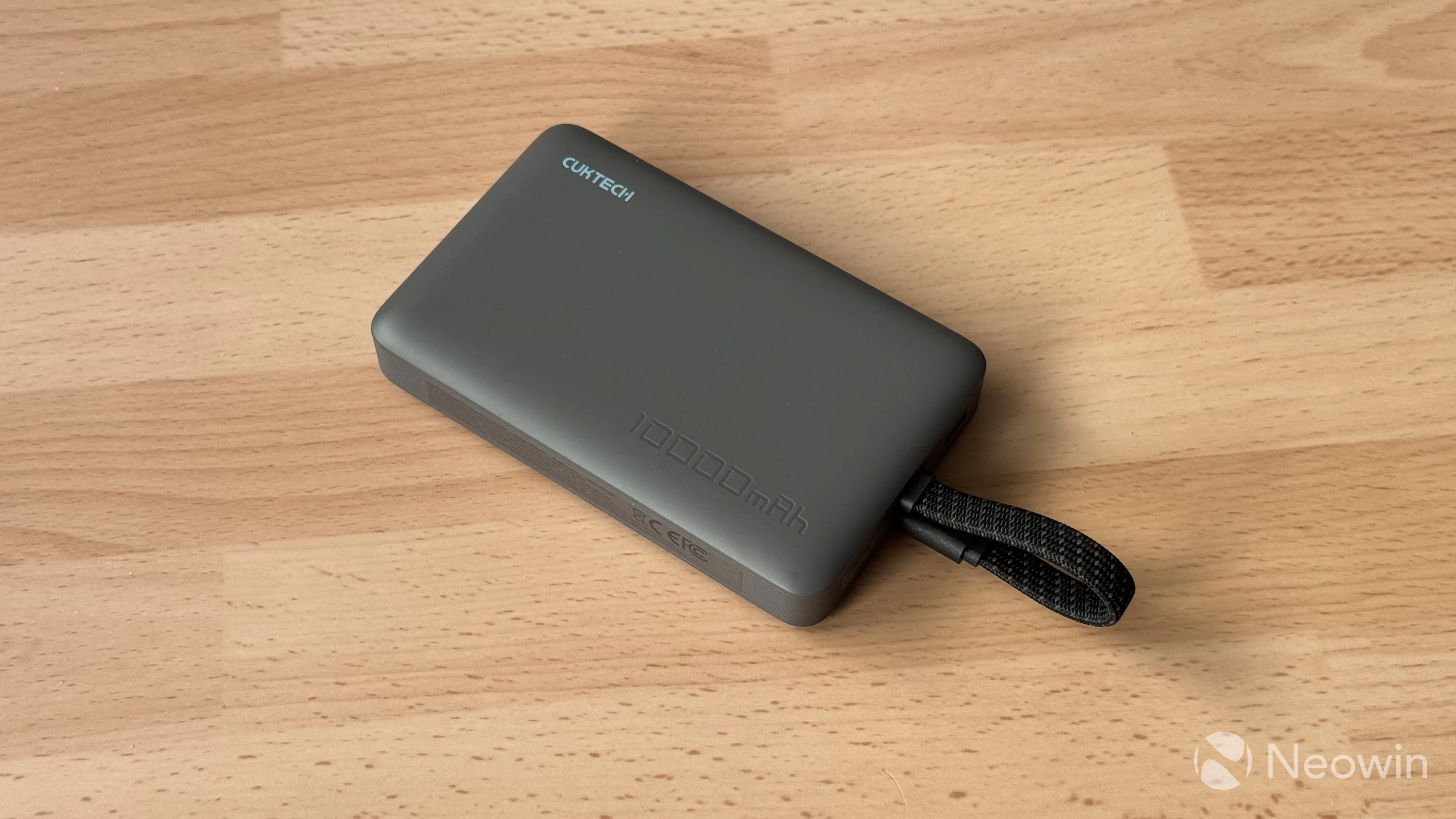

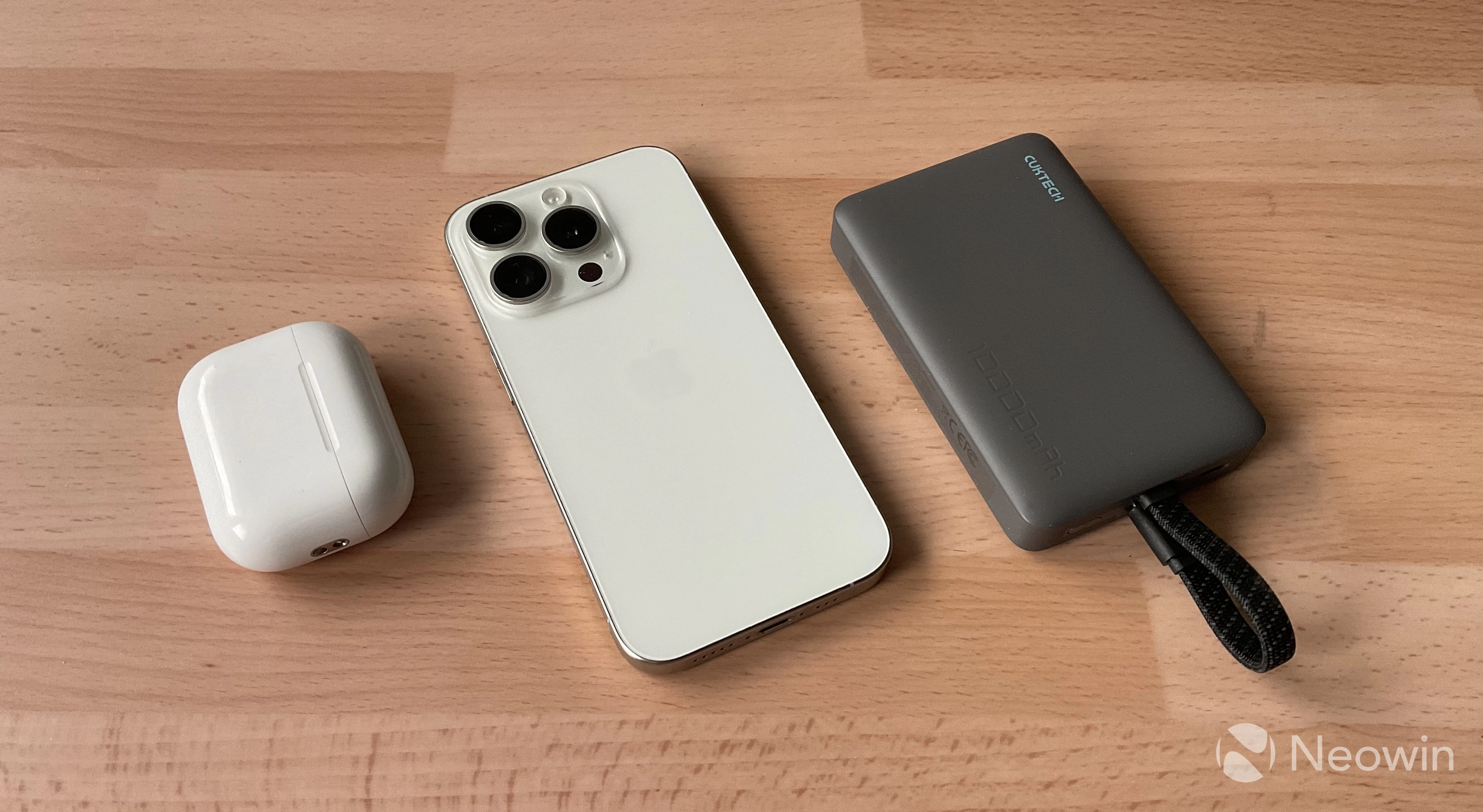

The CP12 is a "travel-friendly" power bank that does not take up too much space in your backpack or even in your pocket. Besides being small and light (only 211 grams), it has a fixed USB-C cable, so you do not have to take one with you. Also, there is one more USB port allowing you to charge an extra device in wired mode (three total).

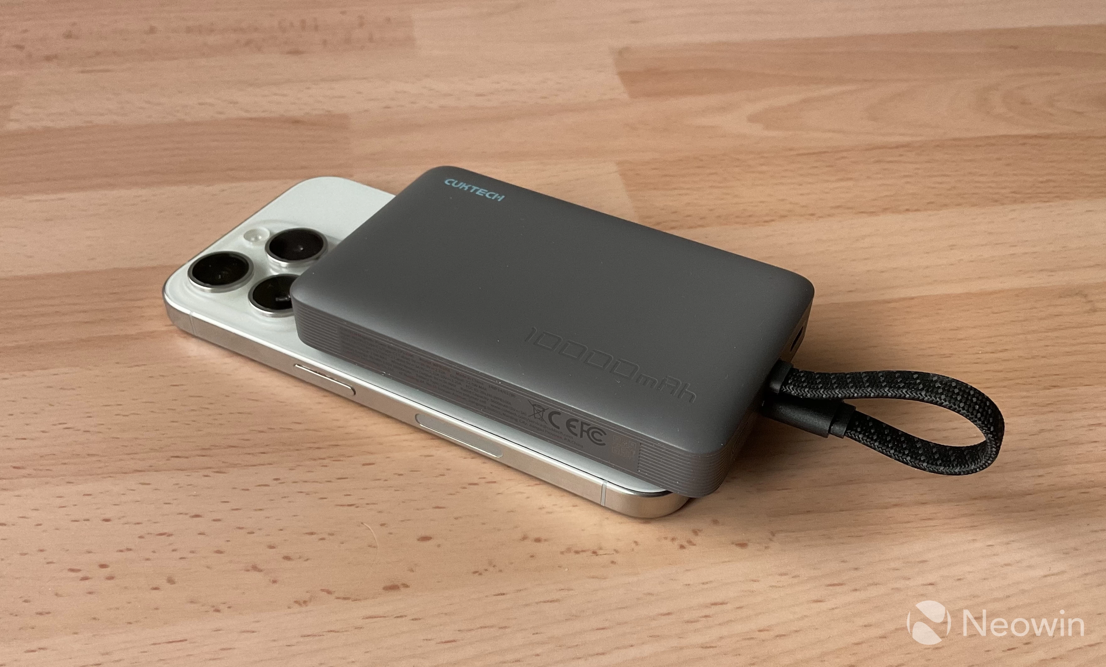

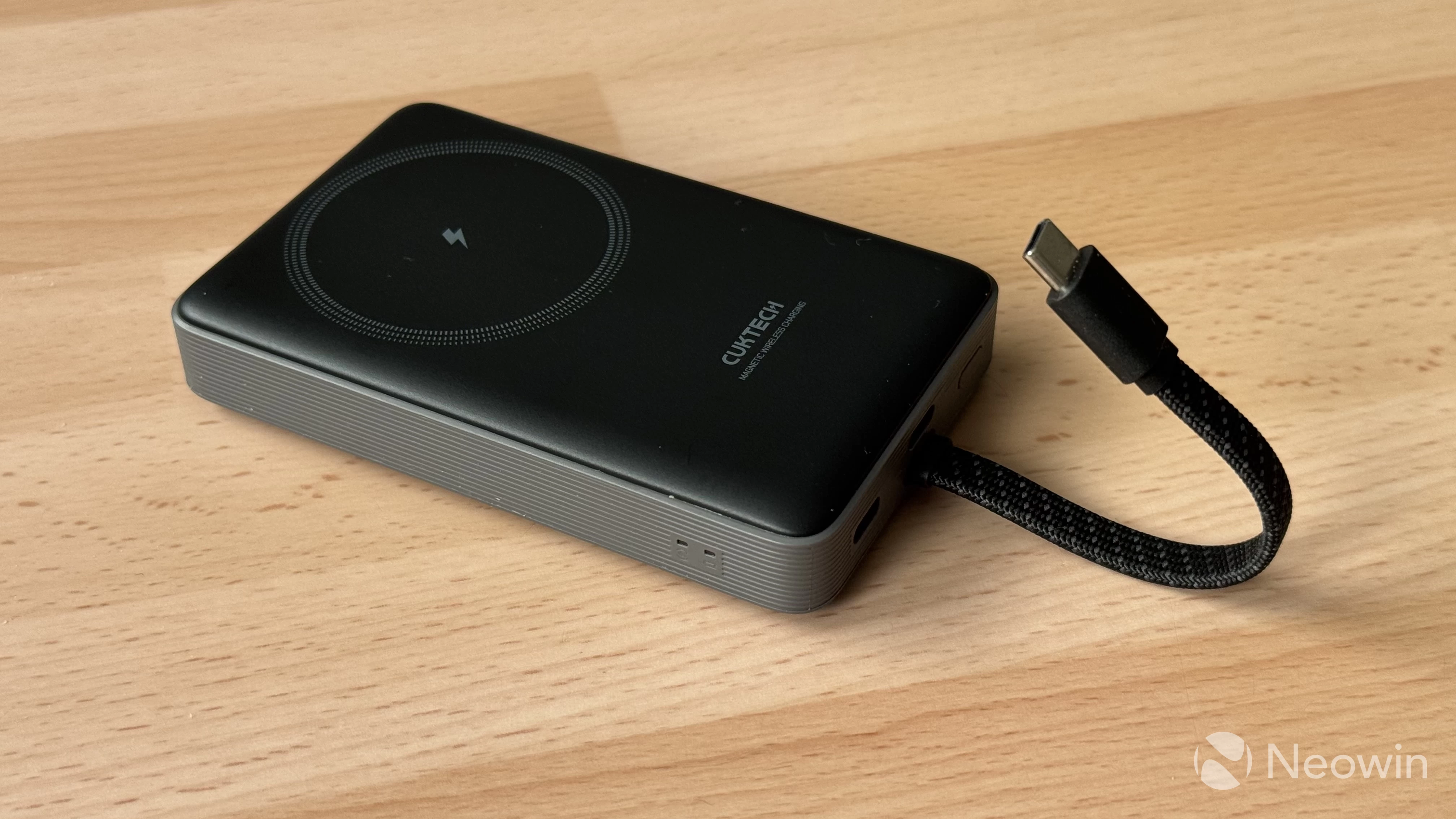

In addition to wired mode, the Cuktech CP12 supports wireless charging with MagSafe compatibility. If you have an iPhone 12 or newer, you can snap this power bank to the back of your phone to charge it wirelessly (AirPods are also supported). The magnets are very strong, and they have no problem with big devices. During my testing, I could hold my iPhone 15 Pro with a MagSafe case by just the power bank without worrying about it falling off.
The only thing I do not like is that the wireless charging surface is made of rough plastic. I wish it were made of softer plastic to avoid long-term stains and scratches for those using their iPhones without cases. After a few weeks of active use and wireless charging, the surface already has plenty of scratches.

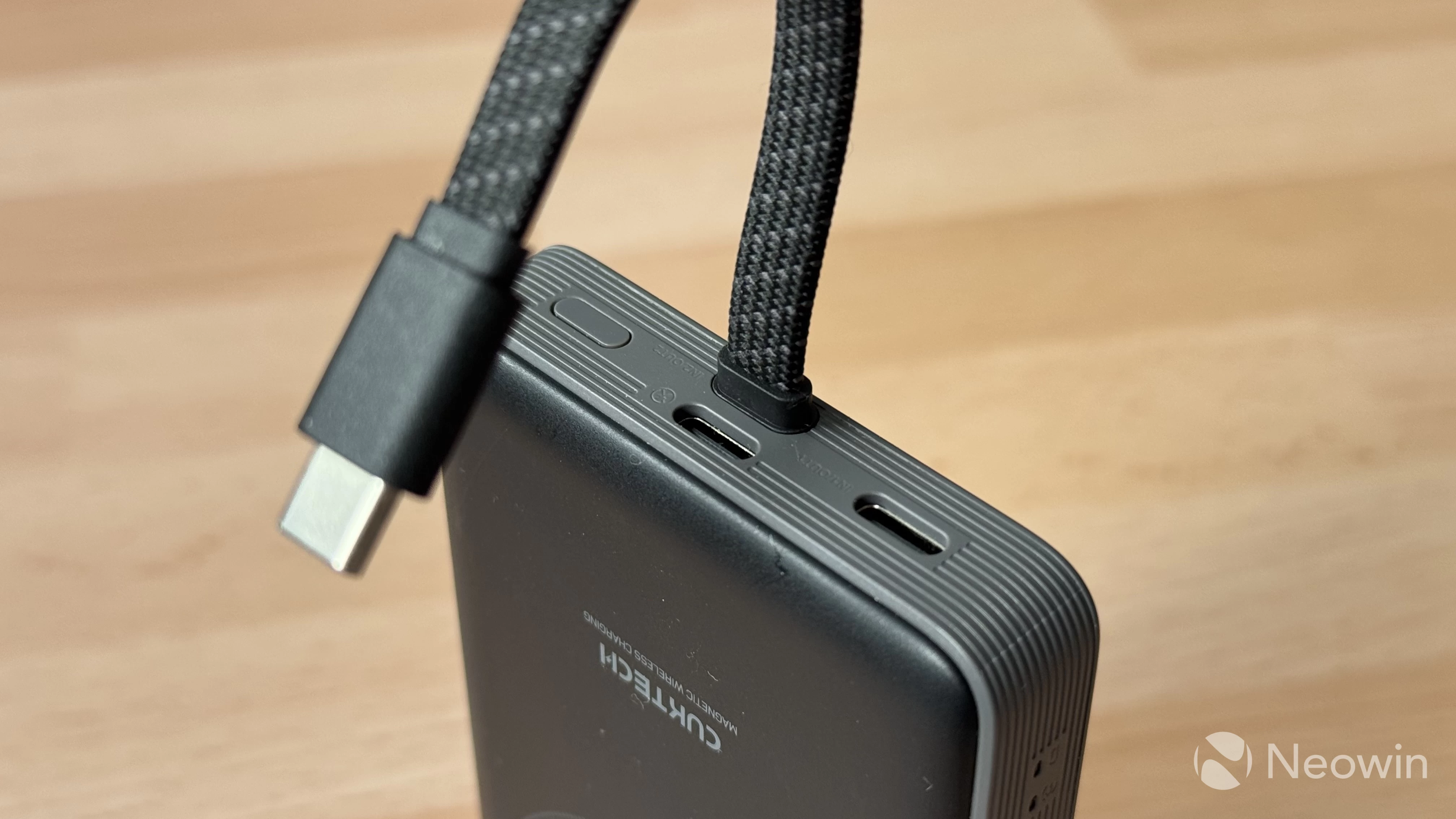

The attached cable is very stiff and strong. It can hold the weight of the powerbank and a phone attached to it, and Cuktech says that it is rated for about 10,000 bends. You can make a loop with the built-in USB cable by plugging it into a dummy USB-C port, which is handy for carrying the power bank. Just keep in mind that the dummy port cannot be used for charging the CP12 or other devices (there is a warning indicator next to it).

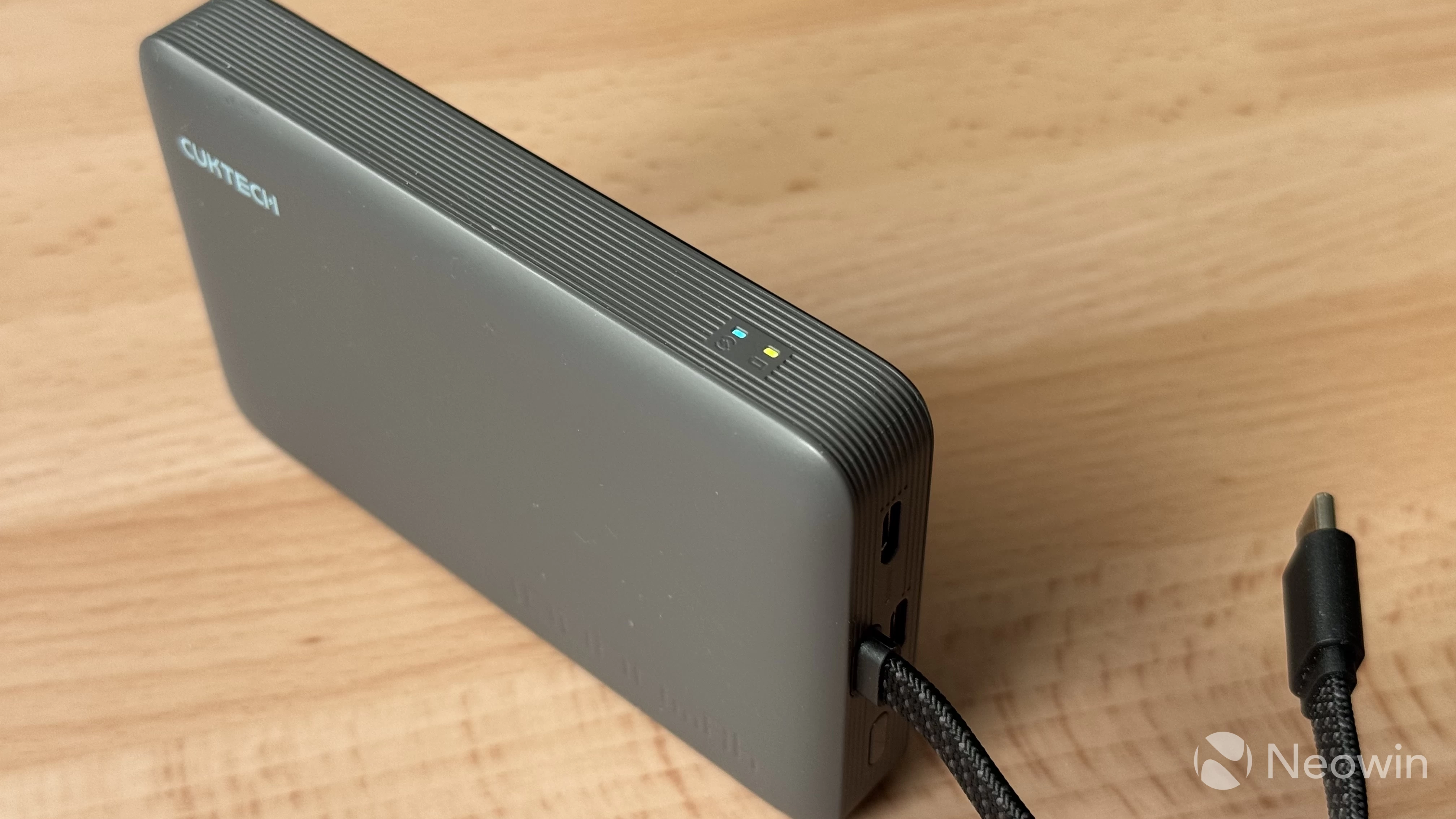

You can charge the CP12 at 20W, and topping it up will take about three hours. Only wired mode is supported, and you can charge it by using the built-in cable (just plug it right into your charger) or with another cable using the extra USB-C port. The power bank has no displays, but you can check its charging state with a side-mounted LED:
  • Flashing orange: 0-30%
  • Flashing yellow: 30-60%
  • Flashing green: 60-100%
  • Solid green: fully charged
