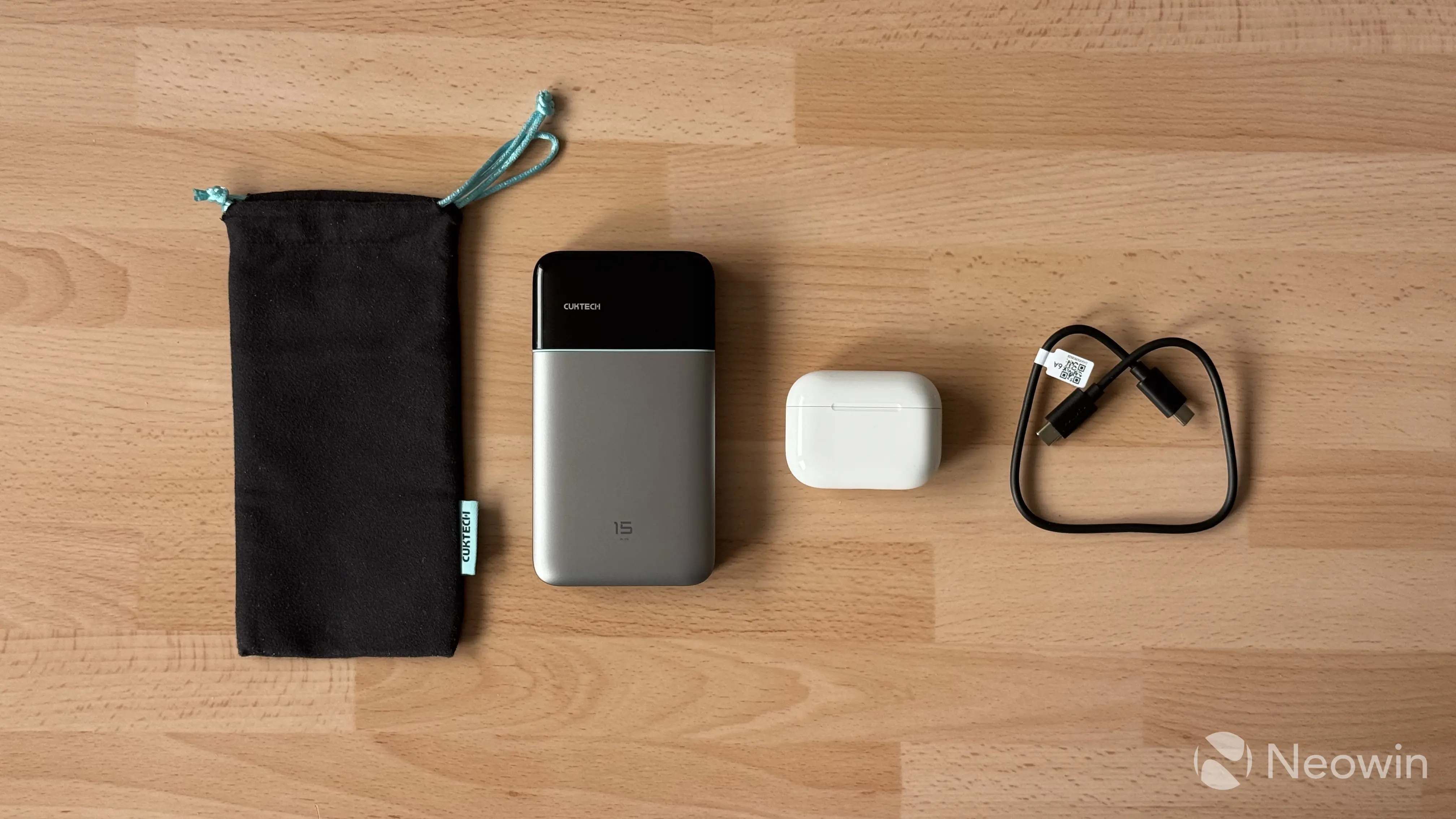

In the box, you will find the power bank itself, a short 1.15 ft cable with 240W max charging support, a protective pouch with a separate compartment for the cable, and some documents. It is nice to see that Cuktech bundles its power banks with quality cables.

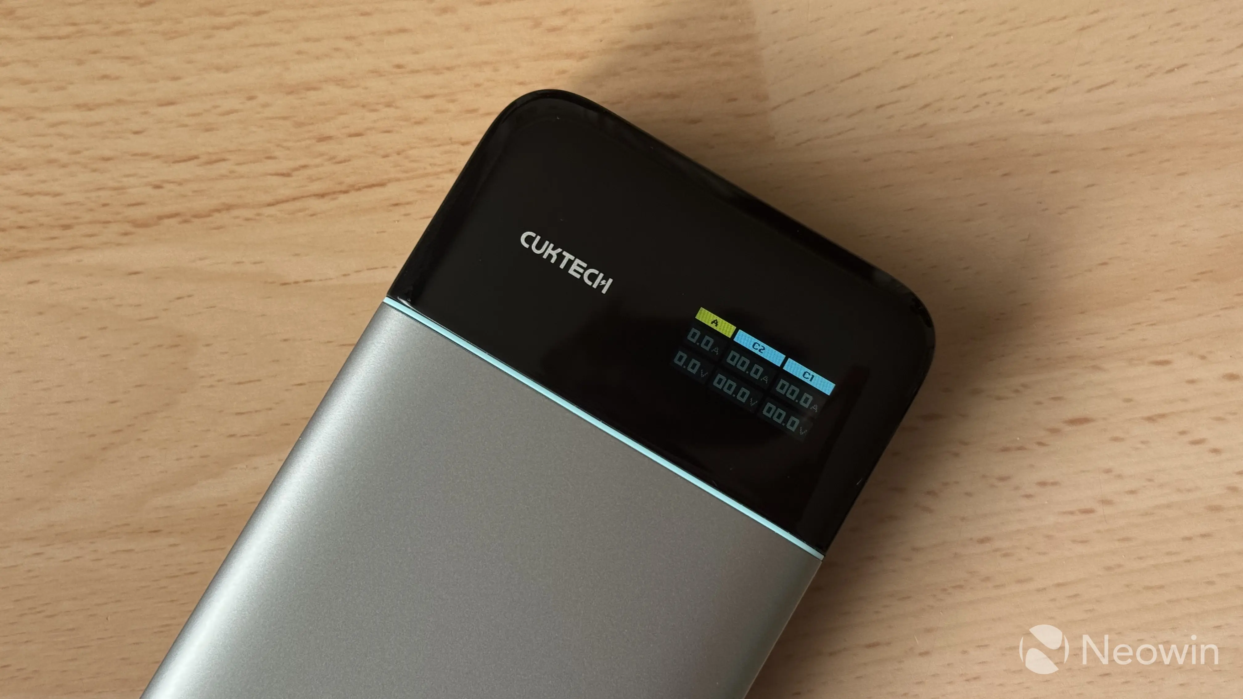

The 15 Air is a stylish-looking power bank. It has the company's staple silver gray color with a black texturized back and a glossy black plastic covering part of the front, which has a Cuktech logo and a discrete display. When the power bank is off, the display is completely invisible as it blends with the piano black top of the power bank. I like this design, and you can tell the designers put effort into making the power look and feel premium and expensive. Good job.

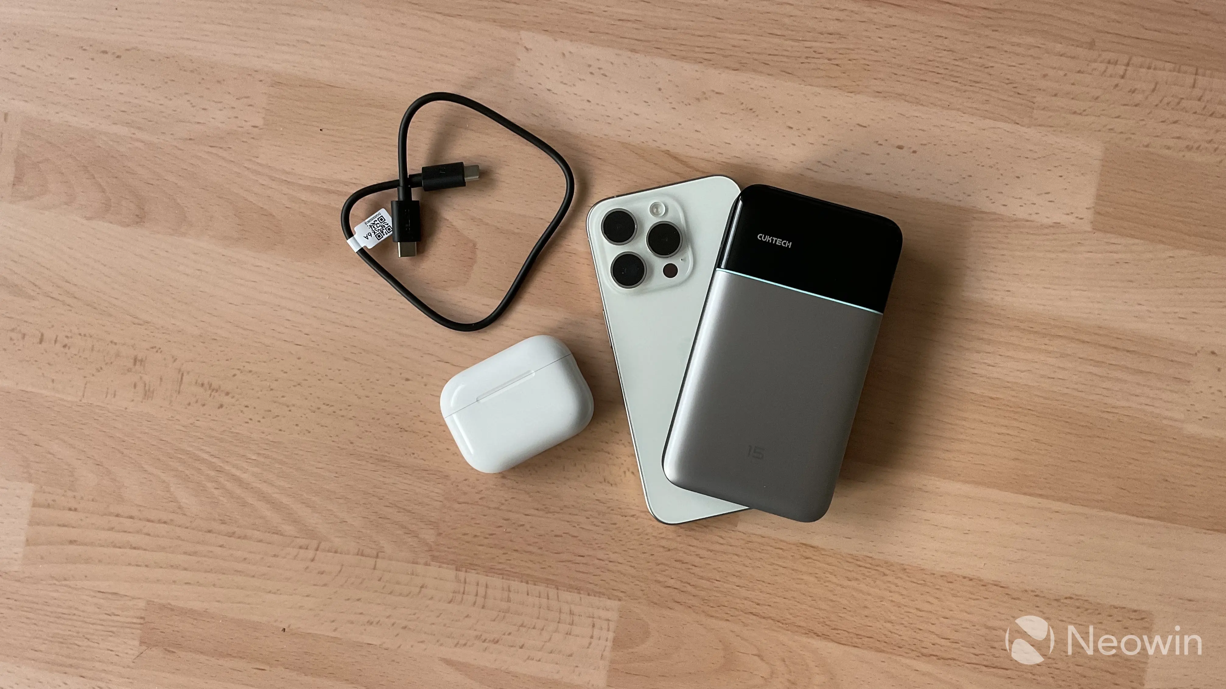

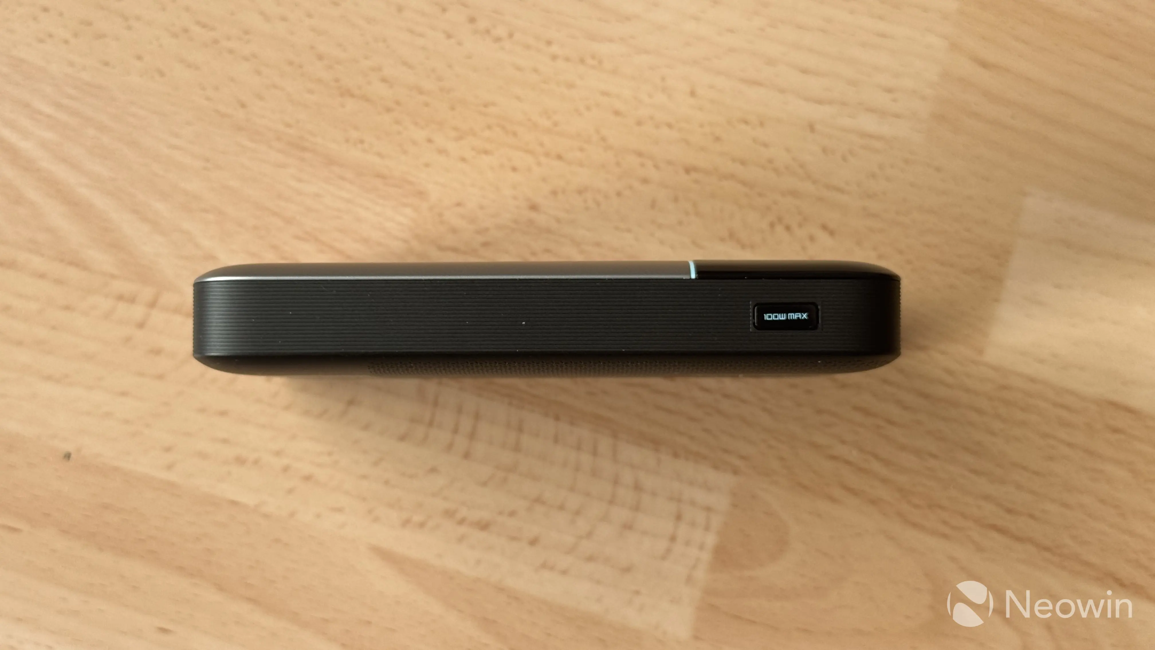

On the right side, there is a single multi-function button with a prominent "100W Max" inscription that indicates the total input/output power. Pressing it once wakes the power bank and turns on the display. Continuous presses toggle between additional views, and a long press lets you change modes for the first port and toggle always-on display mode. You can also hold the button to flip the screen, which is a small but kinda handy feature when the power bank is on the back of your phone. While it is not MagSafe-compatible, its dimensions are just perfect to keep it on the back of a modern iPhone Pro Max when charging. Finally, a double press enables low-power mode for charging stuff like fitness trackers or similar devices with small batteries.

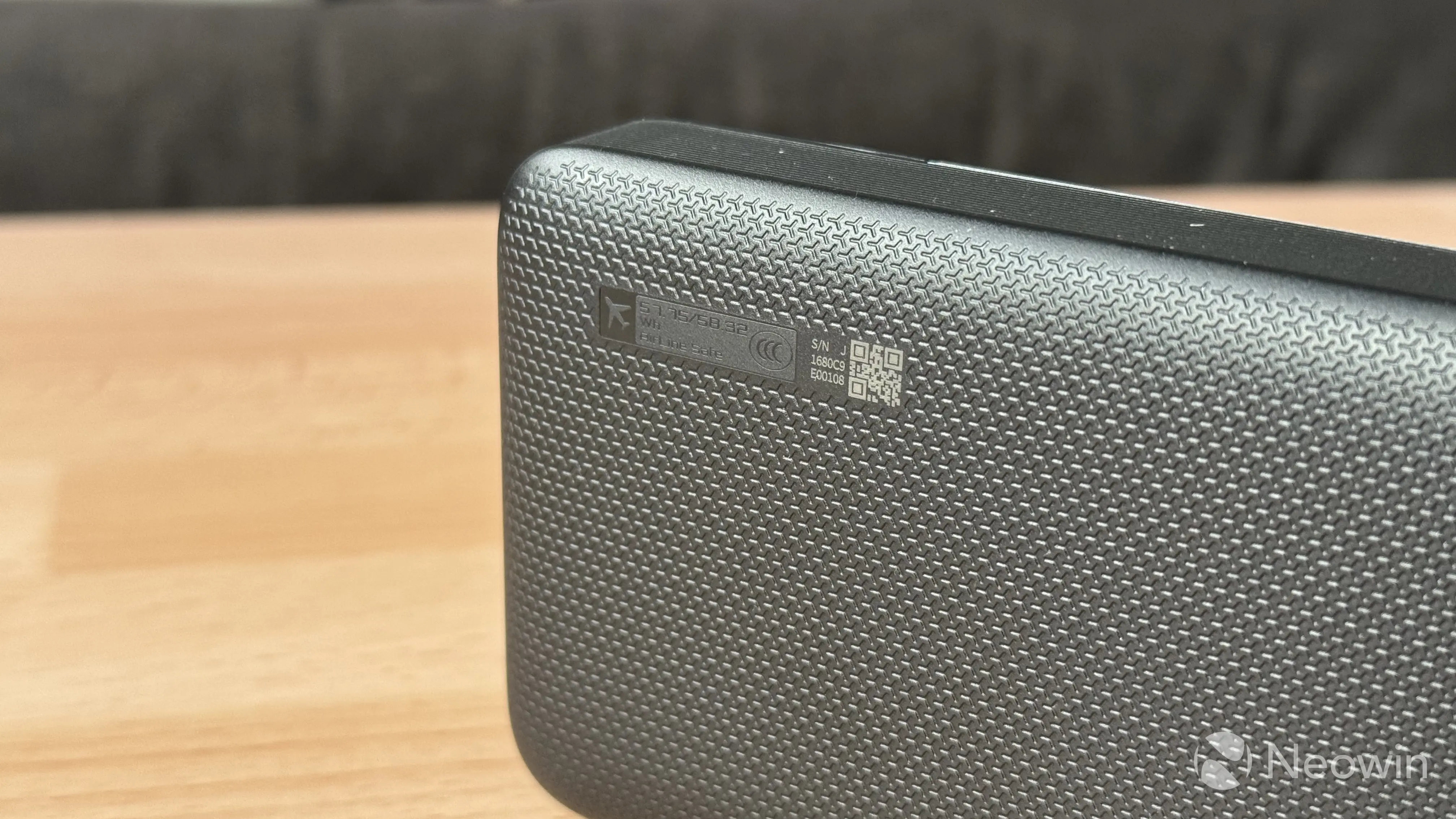

Cuktech's power banks have their battery capacity written on the back, next to an aircraft icon, indicating that the device complies with the FAA's 99Wh limit. That means you can take the power bank on a plane without breaking any rules.

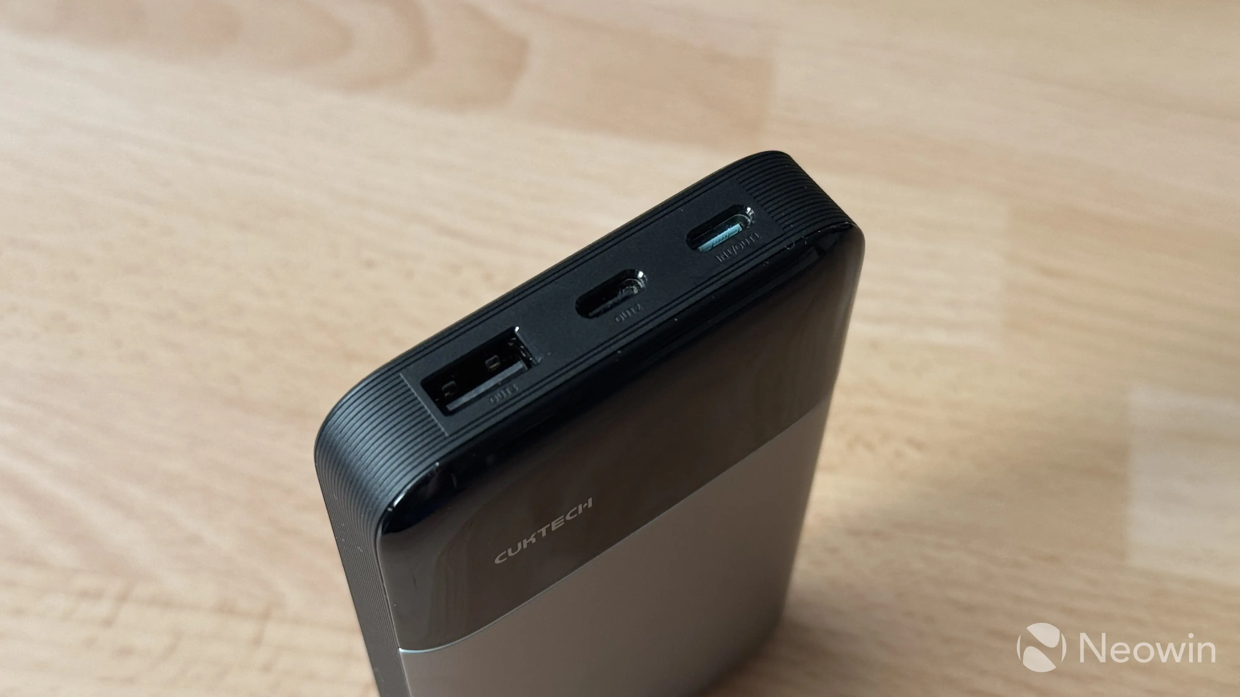

Despite the small size, the Cuktech 15 Air still has three ports: two USB Type-C and one USB Type-A. You can use all three for charging other devices, but only the first port with a cyan connector is for charging the power bank itself. I like these subtle color accents across the device, as they give it a little more character. Plus, you can always see where to plug the power bank to charge.

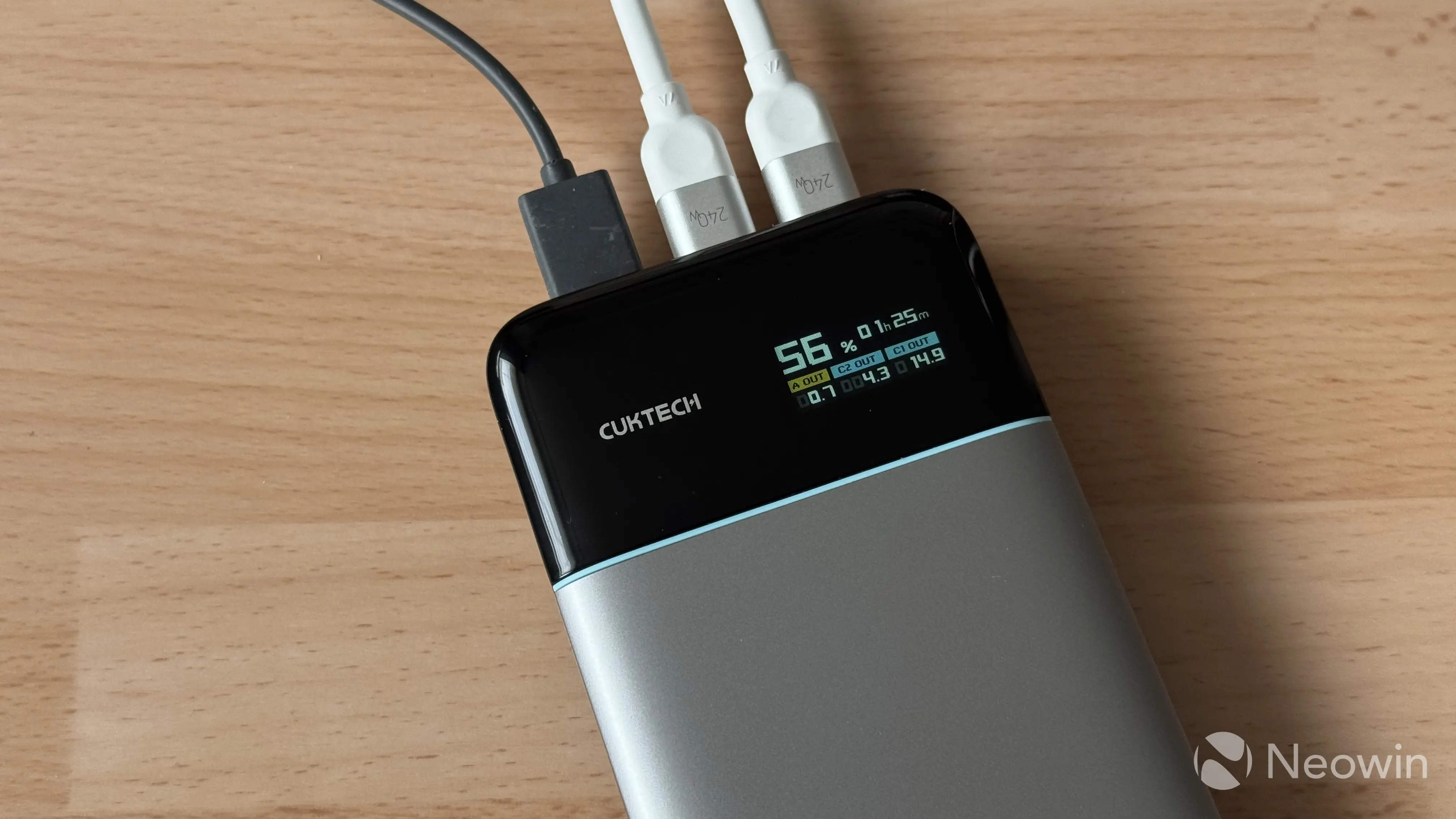

All the input-output data is displayed on the built-in screen. It can show the following:
  • Current charge level down to two decimals
  • Estimated charge/discharge time
  • Total power output for each port
  • Voltage and amps for each port
The display is alright for indoor use, but outside, the brightness is too low for readability.
