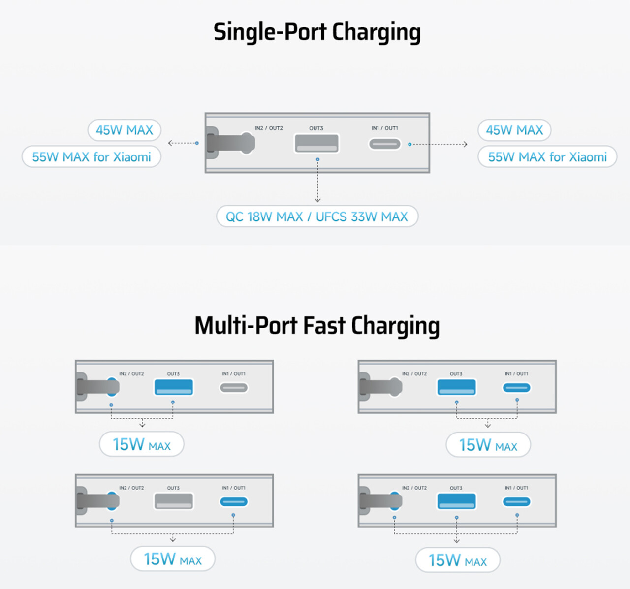

There is not much else to benchmark here; the maximum charge rate of 45W is exclusive to one device that is connected and compatible with that rate. Plug in two devices, and that rate drops considerably as the load is shared. This is typical of all power banks, regardless of whether the other device connected only supports the slowest speeds available.
To get the lowdown on what the charge rates end up being if you do decide to charge more than one device at a time, then the below diagram visualises it perfectly:
cuktech
So, if you want to make use of fast-charging beyond 15W per port, then only have the fast-charge device plugged in!
