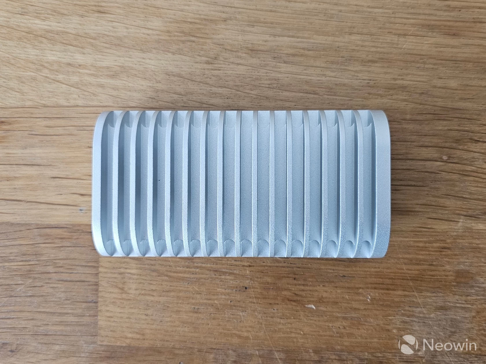

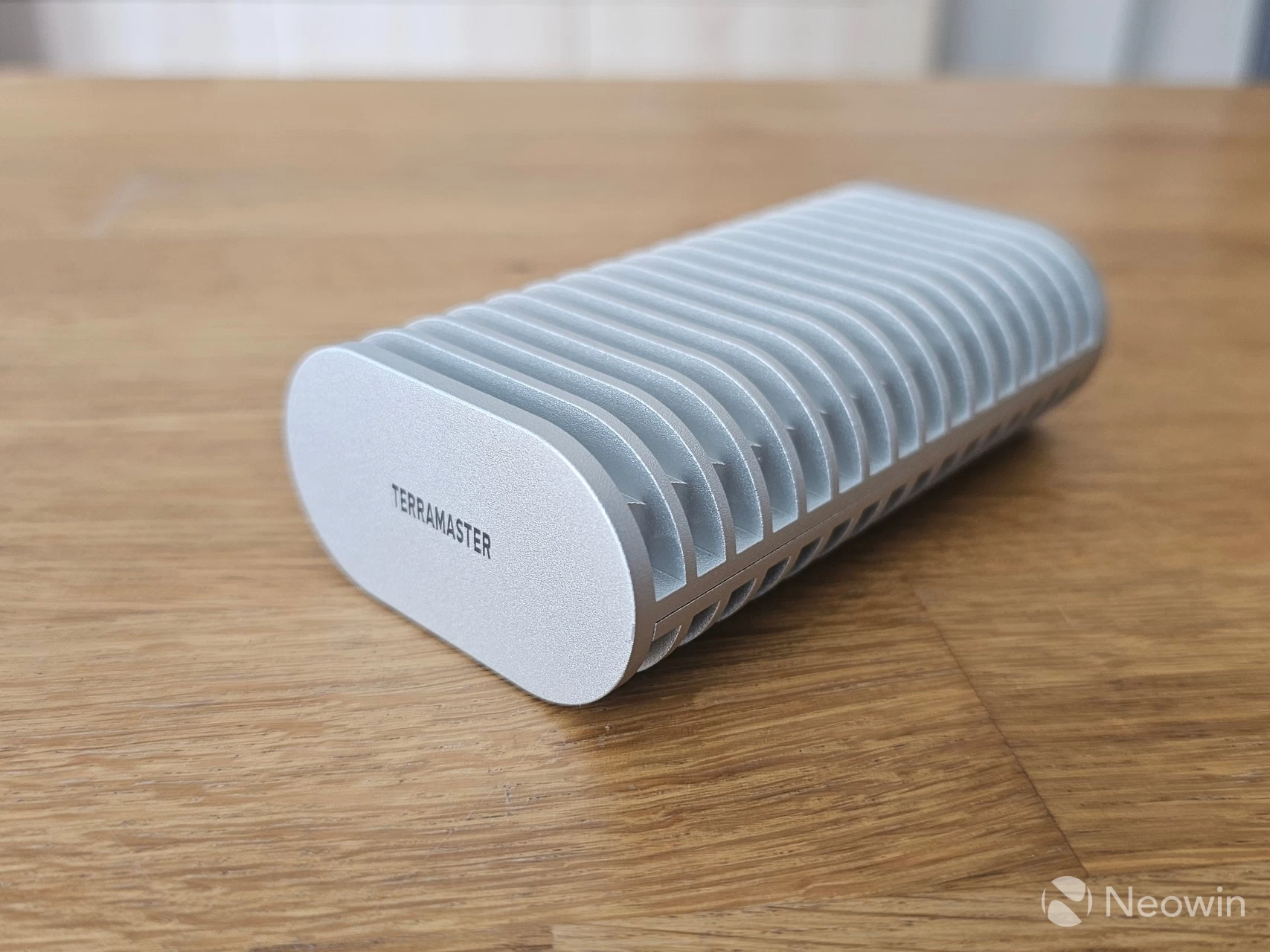

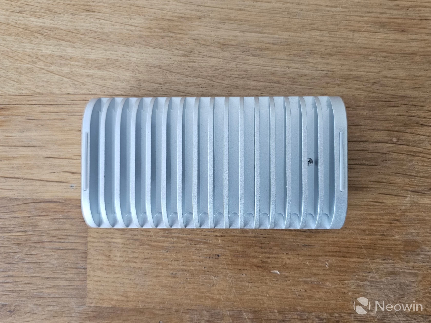

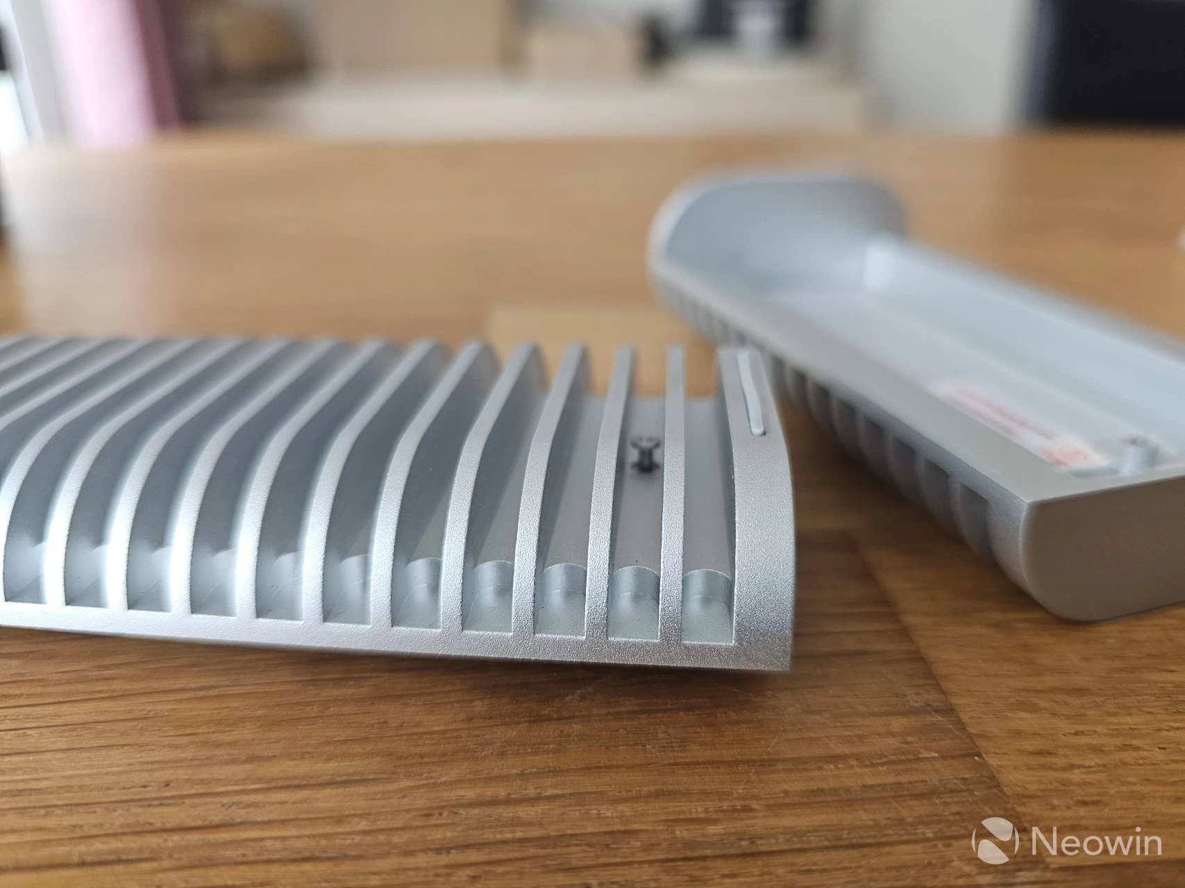

I"ll just say it, the design of the D1 SSD Plus is really great. It is basically one big heat sink made from metal, and it is cold to the touch when not powered on. As can be seen in the specs, at just shy of a quarter of a kilo, this has a good heft to it as well.

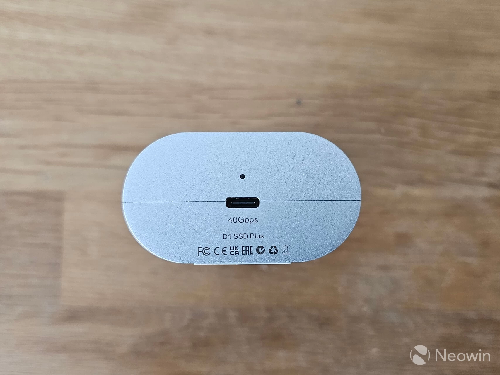

Above you can see it from all angles, the underside has one screw that stays in the frame when loosened. On one side you have the port and certifications along with an indicator (white) light above the Type C USB port:
  • Indicator light Blinking: Read/write status
  • Indicator light Steady on: Idle status
Around the other side, the printed TERRAMASTER wordmark can be seen.

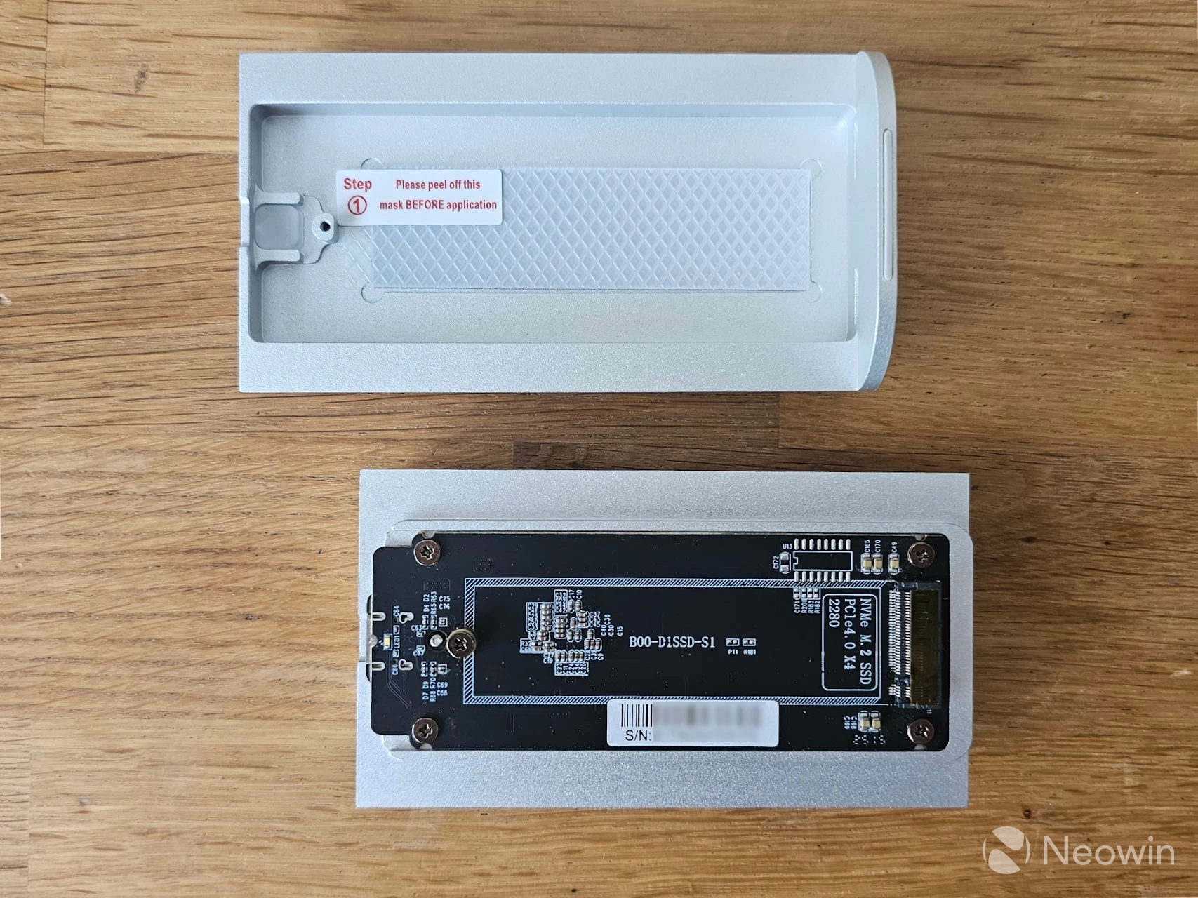

Teardown

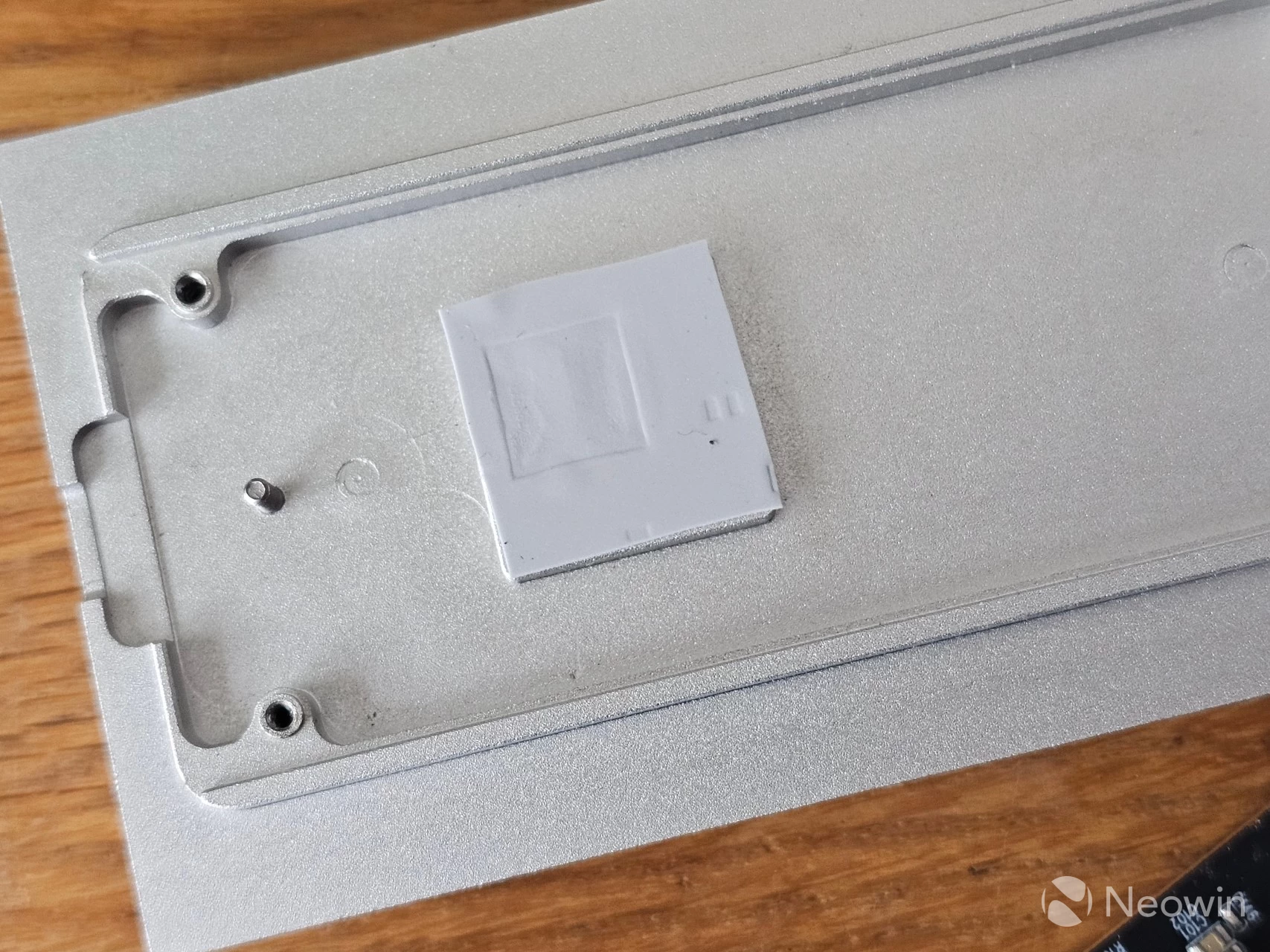

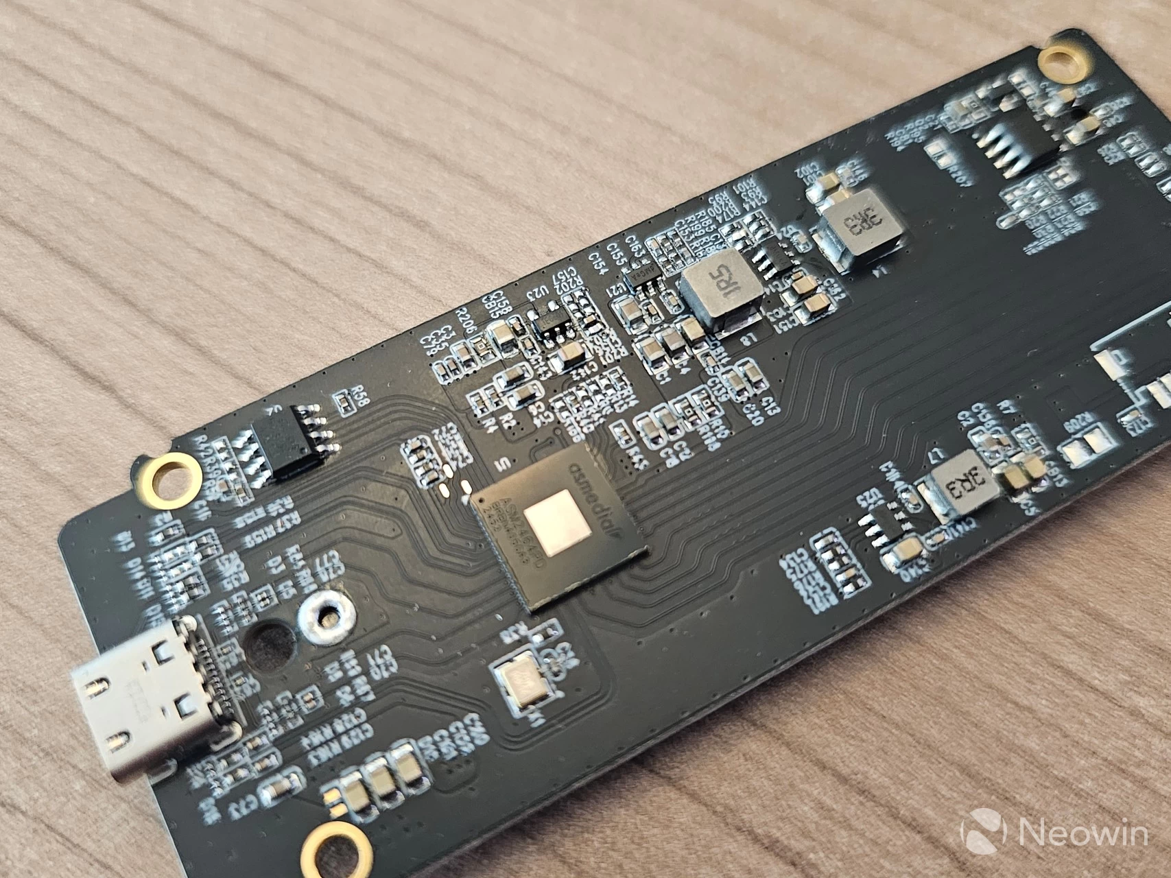

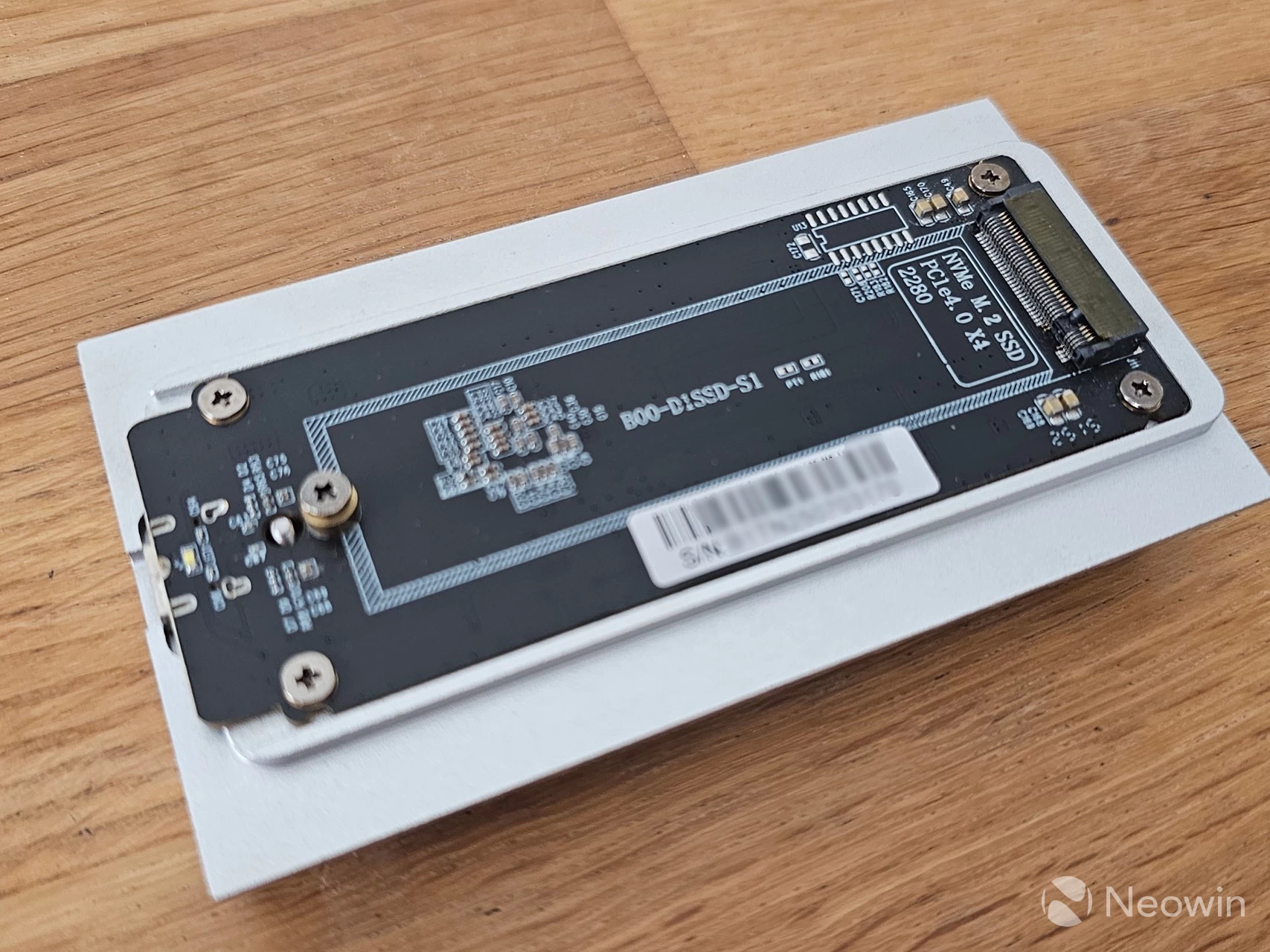

After removing the four screws of the PCB, and turning it over, the ASMEDIA ASM2464PD chip can be seen along with a relatively large amount of SMD capacitors, this ensures voltage stabilization, power failure protection, and data safety. As well as its advertised USB4/Thunderbolt 4 20Gbps x2 speeds, the ASM2464PD chip is also backwards compatible with existing USB 3.2 ports and Thunderbolt 3.
The inside of the heat sink also includes a thermal pad to deal with the high speeds the chip generates.

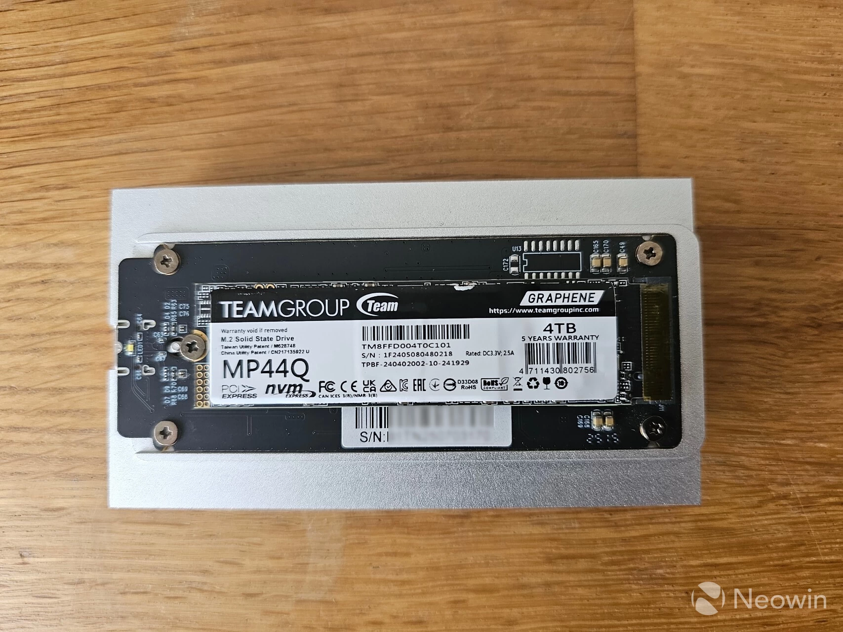

For our review, I used an MP44Q 4TB NVMe SSD ($219.99 on Amazon or Newegg) that TEAMGROUP supplied us with. Installation is simple, simply unscrew the Philips screw on the bottom of the D1 SSD Plus and, pull apart to access and install your 2280 M.2 NVMe with an M2 screw. Yes, instead of a latch system, which I am a fan of, it uses a small M.2 screw to fasten the SSD.

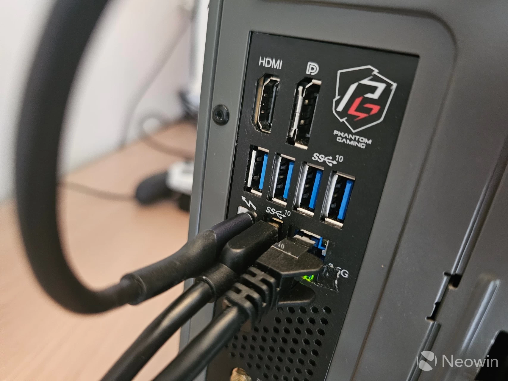

Reattach the two pieces and secure with the screw (which does not fall away from the casing) and plug the provided cable into the D1 SSD Plus, and your USB 4 port.

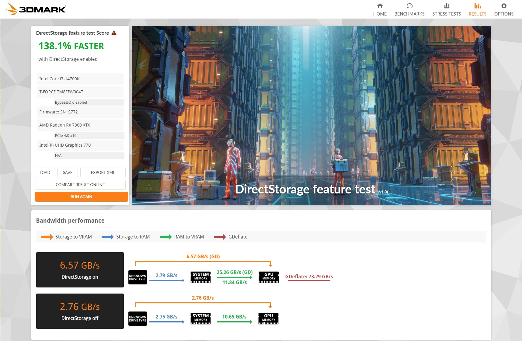

Our final benchmark was the DirectStorage feature test that measures game data transfer speed with and without DirectStorage. The DirectStorage feature allows faster data movement during gaming by removing as much of the OS overhead as possible, and this leads to faster game asset loading that in turn helps to improve the overall gaming experience.
The test clearly shows a huge boost in throughput (nearly two and a half times) with DirectStorage enabled. While that is indeed great, DirectStorage is very much game-dependent, and so the title itself has to support the feature, and unfortunately its adoption so far is not all that widespread.

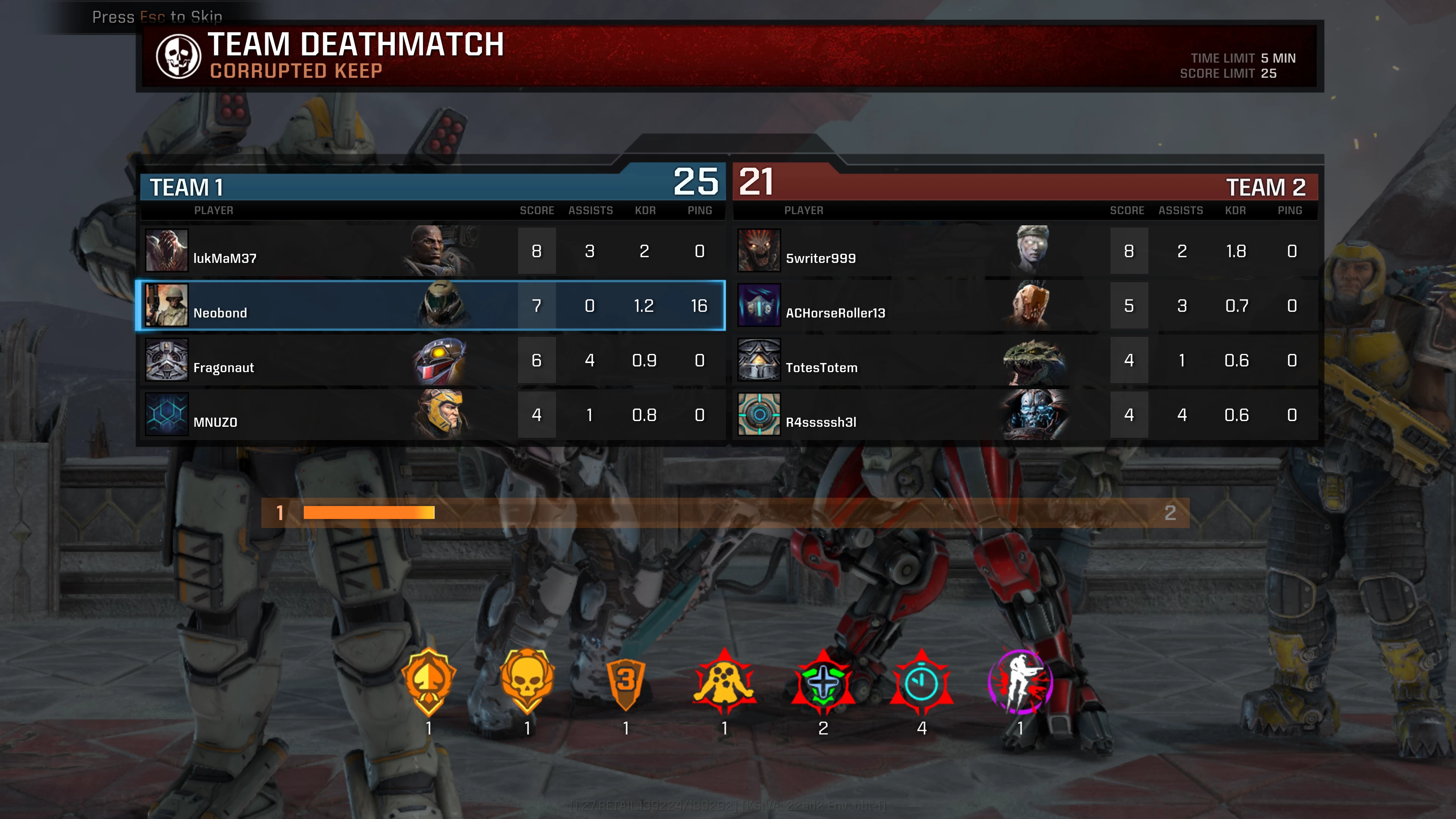

Real world gaming you say? Yes. I decided we needed another testing scenario, so I fired up Steam and added a new library location pointing to the D1 SSD Plus. Then I installed Quake Champions, which utilizes image-based textures heavily, especially in its character models and environment details. And, let"s be honest, this is not a new game (early access testing began in 2017) but it is still being updated and developed, therefore relevant!
Personally speaking, I haven"t really had much time to play it. I used to play at least a couple hours each night to wind down, and well, it shows from my score, but I also recorded the gameplay with HWiNFO running in the background, and what does it tell us? Well, my i7-14700K, with 32GB of XTREME DDR5 6000 MT/s with a cache latency of 30 does not even break a sweat.
As for the D1 SSD Plus, it does not go over 32C in the 10 minutes of gameplay, and 12 minutes I recorded, and that"s with a total writes of 5,7GB and 32.1GB read. This despite the Kingston FURY Renegade PCIe 4.0 NVMe M.2 SSD reaching a peak of 72C (*reminds self to buy a heatspreader for it).
