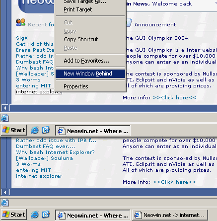

When I'm reading a website in IE which has lots of links, I find that I open those links in a new window and then switch back to the previous window to continue reading that website. In order to minimize the time it takes to do that, I decided to write a menu extension to automate the process. When I right-click on a link, I can now select an option which automatically opens a new window and then brings the previous window back to the front. If anyone else is interested, here it is.
Edit:
See below post for version 2.0. New feature is the ability to open links by drag & drop.
newback1_1.zip
Edited by em_te

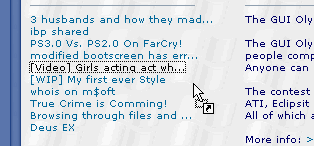

Okay I've tried to implement that functionality as much as possible. With this release you still have to right-click and select the menu option for thefirst> link. But on subsequent links you can just drag and drop those links back on the same window and they will open automatically.
newback2_1.zip
Edited by em_te
