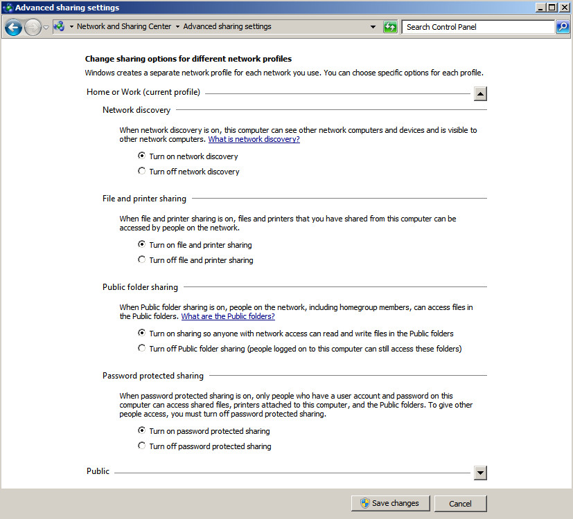

btw - post a screen shot of your share center settings for grins, your also in a home/private network not public right?
example
post-14624-0-36429500-1332587301_thumb.j
This will show current profile and if you have anything shared to everyone/anon, etc.

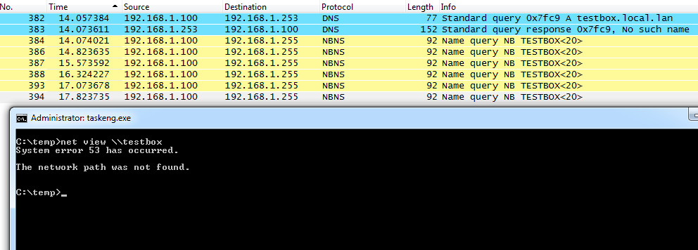

Just so what we are talking about jnelson, which I highly suggest you fire up wireshark so you can see this on your own network anyway.
Here is me trying to find a machine called \\testbox -- which does not exist btw.
post-14624-0-31285000-1332599125_thumb.j
Notice my box try dns first, adding my suffix local.lan - which clearly dns says sorry bud no record.
So then it broadcasts! the 192.168.1.255 address -- no response

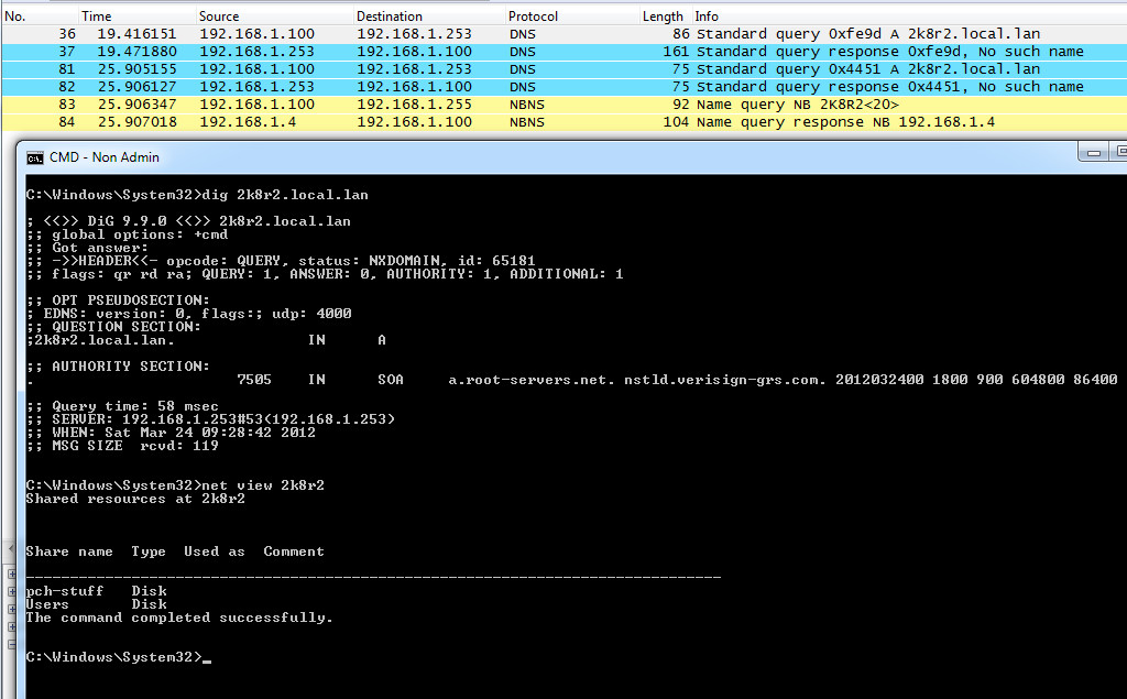

So here is one that answers via broadcast, notice the 2 dns queries - first one is one I did directly with dig to make sure I removed it and it wouldn't answer ;) And then 2nd one is when I did the net view, then it broadcasted and got an answer
post-14624-0-86134300-1332599480_thumb.j
