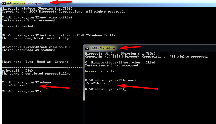

Here I finished moving my 500GB disk to my new 2TB one -- so I could disconnect and give an example
So here I auth inside a elevated prompt and I can view the shares, but in non admin prompt same user, access denied
Now I changed the password on that machines budman account not to match my local budman's account
But yeah UAC and elevated prompts can cause you some issues, explorer to does not run as elevated even your account is admin, etc..

Not from your screenshot with error 1219.. That was clearly showing you had created a session to that machine with a different account. You can only ever be authed to a machine from the same IP with 1 account.
if you auth with say guest, which is access denied you can not then send billy's account info to auth with until that guest session has been disconnected.
It is possible that you had some infection that was creating the session to the box with some account (guest maybe, random maybe) Which would then keep you from authing with the correct creds while there was that other session open.
