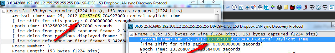

edit: Ok -- what part of taking these traces at the same time was hard to understand?? Its pretty pointless to take sniff to see if packets are being sent and seen if you not taking the traces at the same time.
So I see broadcast packets to your lap from desk, but NO nbns queries that your desk sends out??
Is that because these traces where not done at the same time???
Here is what looks to be common packet, but times are no where close
post-14624-0-29096200-1332686399_thumb.j
Look at id of packet, and yeah they are not same... If you want me to help, send a trace taken at same time!

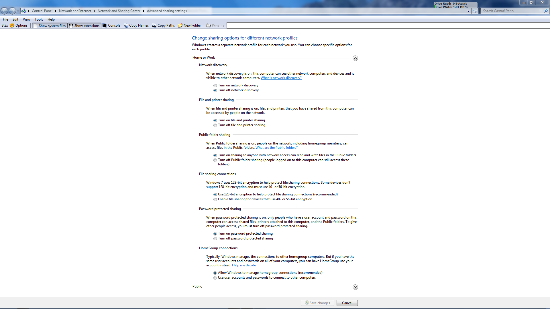

Are you going to post your share settings.. Do you have public shared? etc. etc.. 2 minutes access to your machines and you would be fixed, or we would atleast know what the problem is -- ie if you can not resolve names we would KNOW!
Why do you have homegroups manage?? Are you using homegroups? Sharing works different if you want to use homegroups.
Turn that off if your boxes are not members of the same homegroup. Homegroup would require ipv6 as well.

I also disabled homegroups from advanced file sharing.
