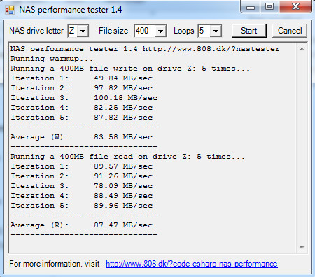

I am serving up movies off one of my VMs - which has 3 drives in a drive pool (drivepool from stablebits) And getting 80MB+ per second both write and read to this share from my workstation. I personally don't think a 15k drive is going add much to this sort of I/0 over a 7200rpm drive.
