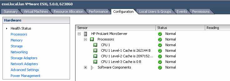

BTW - question for you, do you have or do you know how to enable the other hardware listings in the health section.. I have tried installing the cim providers from HP.. But has not added anything.. Would like to see fan and hdd, etc.
I get no health information display either. I too would like to be able to at very least monitor the HDD's SMART capabilities.

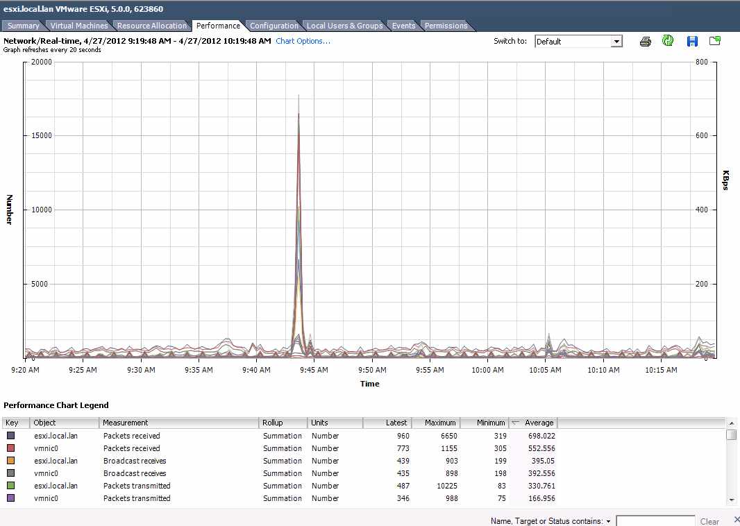

Have you taken sniff using one of your vms -- is it possible that your vswitch is swamped with other traffic, maybe a broadcast storm or something going on? Turn on all the networking items -- do you see anything weird.. Mine is pretty much zero -- not doing anything currently.
post-14624-0-81550800-1335540080_thumb.j

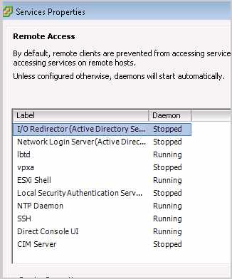

Under your security profile - what services do you have running/stopped?
All off, except:
tbtd
SSH
Direct Console UI
