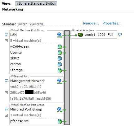

Just a thought - my pfSense is running in promiscuous mode, could this somehow be effecting things?
Could it be that every time I do a network transfer involving these VMs the pfSense VM is receiving every packet pushed over the Virtual Switch?
Yeah, if your vswitch is promiscuous mode?? It sure couldn't be helping performance.
Now I just created a new port group to be able to mirror the traffic that goes to the internet for IDS and nchronos, etc. But I haven't installed anything yet to the switch port other than my pfsense lan interface.
So mirrored port group is set to accept promiscuous mode, lan port group is set to reject
But if you have your whole vswitch in that mode, then set promiscuous to reject - does that help? Didn't we go over your vswitch settings already.
Well - I decided to move some stuff around to see if I could improve performance at all. I moved pfSense to it's own group similar to what you've done and set Promisc to Accept, the rest of the LAN Group is set to Reject.
I'm seeing about 450Mbits/sec over IPerf to most machines on my network on average.
