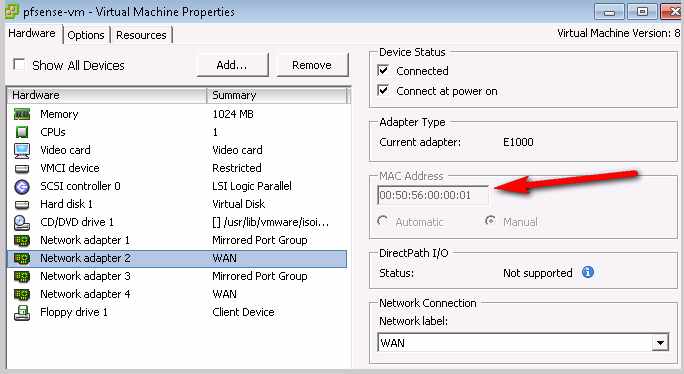

What?? :blink: Do you understand what a mac address is? From this statement I have to think no. So my mac address of my router is wan interface is 00:50:56:00:00:01
hac away!!! ;)
