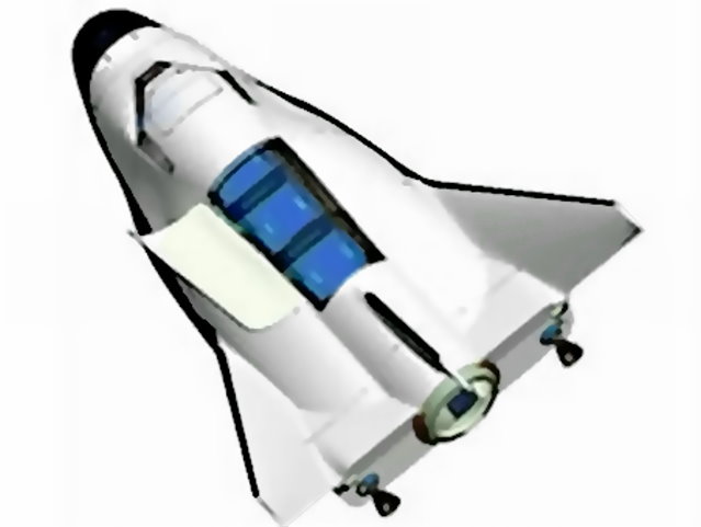

Now that atmospheric flight tests are about to begin and a new concept video has been released, it's time for a new thread about Sierra Nevada Corporation's new spaceplane, the Dream Chaser.
Reviewing: a 7 passenger lifting body commercial spaceplane that initially will launch atop an Atlas V launcher, though a Falcon 9 v1.1, Delta IV or likely an Ariane V could be used with an adapter.
What looks like wings are not - they are the stabilizers. In a lifting body the curvature of the fuselage serves as the "wing." Very advanced aerodynamics its taken decades to get this far. Dream Chaser can land on ordinary airport runways, and it only sees 1.5 G's during re-entry.
Power is by 2 hybrid rocket engines, a combination of solid fuel with a liquid oxidizer. This lets a solid rocket be throttled, shut down and re-started.
The crew and cargo are loaded by a hatch at the top, and it docks with an adapter at the rear between the engines. A cargo bay and compact robotic arm may be added later.

Using a nose skid instead of a wheeled landing gear lightened the structure by hundreds of pounds, and that translates directly into a larger cargo capacity. Put a dolly under the skid, hook up a runway tractor and drive her away. Good call.
