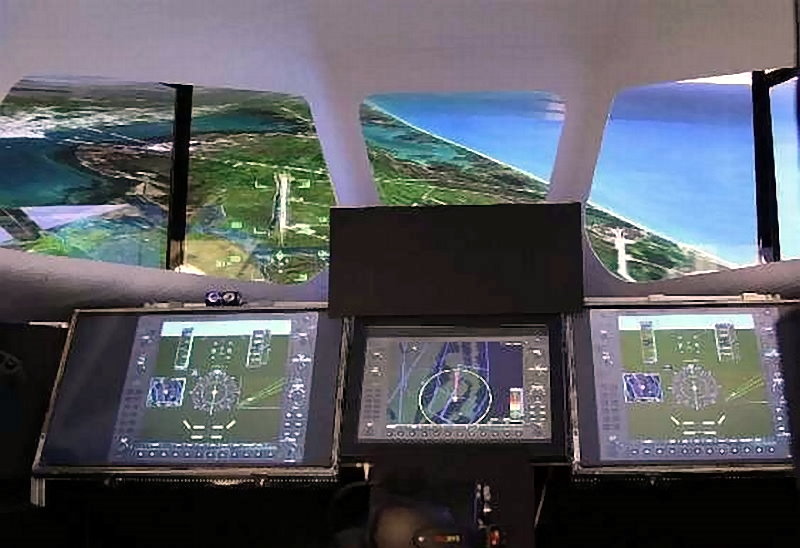

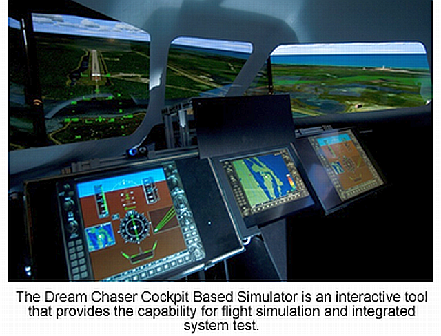

Readiness of a new cockpit simulator for Dream Chaser is verified and is now being used for engineering development tests. The wing-tip fin airfoil design was also selected, so construction of a flight test unit can be completed.
Attached is a pic of Dream Chaser's cockpit simulator. Looks like they went all digital.
nice looking cockpit, cool screens and none of the knobs you used to get with older planes. as for the fuels, if we can regulate fuel used on Earth we should be able to regulate the fuel used in launches to space. i don't like it when space is treated as some exotic industry, and thus is believed not subject to regulation.

Cockpit & simulator has passed its NASA milestone approval
http://www.sncorp.com/press_more_info.php?id=467
Sierra Nevada Space Systems Completes Simulator and Avionics Laboratory Milestones for NASA's Commercial Crew Program
Sierra Nevada Corporation's (SNC) Space Systems announces the completion of additional Dream Chaser Space System Milestones under NASA's Commercial Crew Development Phase 2 (CCDev2) Program. SNC is leading a team of industry partners, universities, and NASA Centers to develop a low-cost space system that will provide NASA with the capability to safely transport crew and cargo to and from the International Space Station (ISS). To date, SNC has completed five of thirteen Milestones under the CCDev2 Program, all on time and on budget. The Program is on schedule to culminate in a high-altitude flight test of the Dream Chaser crew vehicle in the summer of 2012.
In July, the Dream Chaser Program completed a CCDev2 Milestone with a demonstration of the Dream Chaser Cockpit Based Simulator. The simulator, which consists of both a physical cockpit layout and integrated simulation hardware and software, assists Dream Chaser engineers in evaluating the vehicle's characteristics during the piloted phases of flight.
The following CCDev2 Milestone was the Dream Chaser Program's Vehicle Avionics Integration Laboratory (VAIL), activated in September. VAIL is a platform for Dream Chaser avionics development, engineering testing, and integration, and will also be used for verification and validation of avionics and software. The lab is linked to the Cockpit Based Simulator hardware and software for integrated system testing.
Jim Voss, Vice President of SNC's Space Exploration Systems said, "The Dream Chaser team, which includes SNC as well as our industry teammates and our NASA partners, has made tremendous progress over the last four months. Our simulator and avionics lab give us the ability to do engineering evaluations of our complex systems. These successful Milestones, completed on time and within budget, reflect the rapid progress possible in the NASA Commercial Crew Program."
The Dream Chaser team is on schedule to achieve all CCDev2 Milestones as well as complete additional tasks to further advance the development of the space system. In addition to the high-altitude flight test, the Dream Chaser Program will conduct a system-level Preliminary Design Review (PDR) before the end of CCDev2. Through the development of the Dream Chaser Space System, SNC is positioned to quickly restore U.S. capability to safely transport humans and cargo to and from the ISS and return them safely to Earth.
