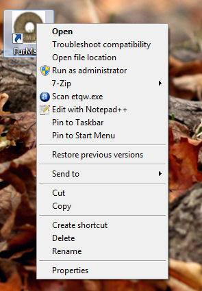

The first picture shows the context menu I get when I right click any file (shortcut, picture, document, video, etc.)

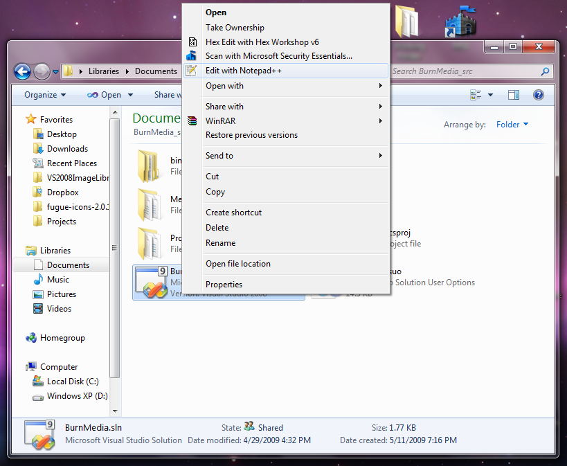

The second picture shows the context menu I *should* be getting. This one only occurs when I right click on a folder, link, the taskbar, anything in the Start menu, or any other system element.
Does anyone have any idea why this is happening?

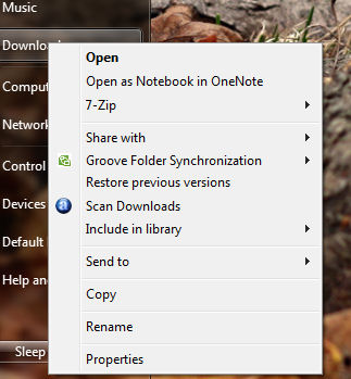

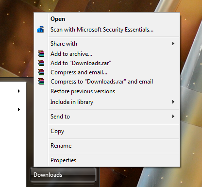

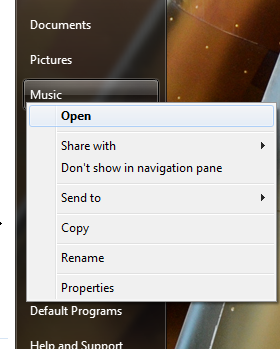

It could be the "Downloads" folder. Music/Pictures/etc point at a library. Adding the Downloads link to my start menu via the SM properties results in the same thing. Maybe it's a direct link instead of a library shortcut?
EDIT: Confirmed. Pulling up the properties dialog on the "Downloads" start menu link gives me standard folder properties as if it were a shortcut. The others give me the Library dialog.
Notepad++ is incompatible with the new style.
REmove the context option and it will be back to normal.
Thanks so much! That was the issue. I used ShellExView to disable the context menu entry. Hopefully Notepad++ can get things moving in Windows 7 soon!
It's because one of your shell extensions is incompatible with the new menu API, which means Explorer has to revert to the old one. It's because the extension displays an image using owner-drawn menus, which is how you would do it before the functionality was built in starting with Vista.

Downloads is an actual folder, the others are libraries.
https://www.neowin.net/forum/index.php?show...amp;p=591835604
Yes, I said that. :) Libraries don't have folder/file properties because they're not a folder or file, so the shell doesn't add SVN/Rar/etc to the library context menu. There doesn't appear to be a way to make a Download library then add it to the start menu. It always points directly to the folder, so it gets folder/file menu items.
