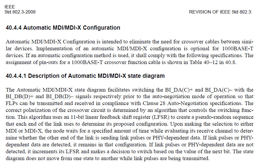

If one of the 2 nics are gigabit nics then a normal cable will work. A gigabit nic will autosense the necessity to cross over and do so if needed, it is built into the gigabit standard protocol. So only one gigabit nic is needed because only one side needs to cross to establish communication.
A cross over cable is where one side is normal and the other is reversed, in hardware one side is normal (say 10/100) and the other side is cross (gig)..only 1 side needs to be gig for this to function.
  On 29/06/2011 at 19:58, sc302 said:
If one of the 2 nics are gigabit nics then a normal cable will work. A gigabit nic will autosense the necessity to cross over and do so if needed, it is built into the gigabit standard protocol. So only one gigabit nic is needed because only one side needs to cross.
Huh, I didn't know that. Thanks for the info!
Guess you don't read your IEEE standards very often then? ;)
Is it just me that reads these things?? Kind of given if your going to work in the field to keep up with the actual standards, so whats next? your going to tell me you don't read the RFCs either? :rofl:
Here is the actual clause in the IEEE 802.3 2008 standard.
Now in the standard it is actually only listed as optional, but I have yet to see a gig nic that does not support it.
