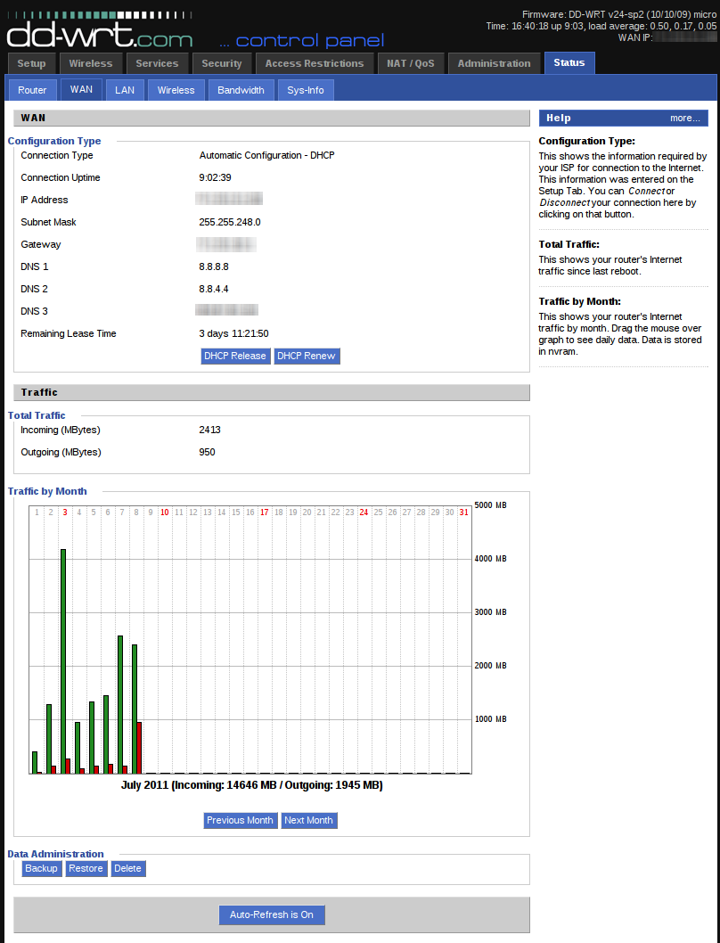

Depending on your router you can flash it with DD-WRT or Tomato. I went with DD-WRT because they have a micro version for routers with very small amounts of memory. It keeps a chart of my bandwidth usage. The bad thing is that when you reboot the router it sometimes loses the chart data prior to the reboot. I've attached a screenshot so you can see what it looks like.

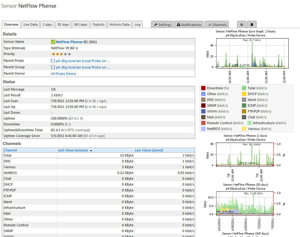

If he wants to track his bandwidth used, sure dd-wrt can do it for him.. If he is more interested in what is going on with the network like top talkers, top protocols, etc. He could send his netflows to any netflow collector, I run prtg for example (free) and have my router send the netflows to the box running prtg so I have this sort of info.
dd-wrt can send netflows, so you could use prtg, you could use NTOP for example that would give him pretty much anything he would want to know about what is going on with his network.
