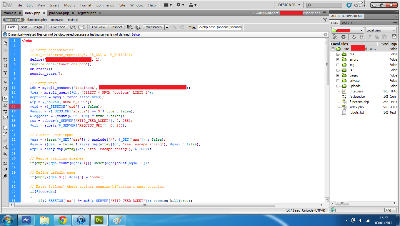

Hi all,
I just wondered if someone knows how to disable a specific syntax error from appearing in Dreamweaver CS5.5, or otherwise how to 'upgrade' Dreamweaver's PHP syntax checker. My problem is:
  Quote
http://php.net/manua....comparison.php
The expression (expr1) ? (expr2) : (expr3) evaluates to expr2 if expr1 evaluates to TRUE, and expr3 if expr1 evaluates to FALSE.
Since PHP 5.3, it is possible to leave out the middle part of the ternary operator. Expression expr1 ?: expr3 returns expr1 if expr1 evaluates to TRUE, and expr3 otherwise.
post-176093-0-08206400-1325605014_thumb.
Running Help > Update shows that DW is up-to-date.
Thanks for any help :)

Edit: Actually it looks like CS5.5 adds support for PHP 5.3 for code hinting at least, so I don't know why not for syntax checking: click. Putting expr2 in the middle of the ternary makes the syntax error go away, but I don't wanna have to write "old-code".

Both come back as invalid... with and without trailing semicolon.
Also, seems like Bugbase is only for AIR & Flash bugs, so reporting here instead.
Edit: Reported! Guess there's nothing more I can do, so I'll just have to put up with a ton of red markers all over my code :p
