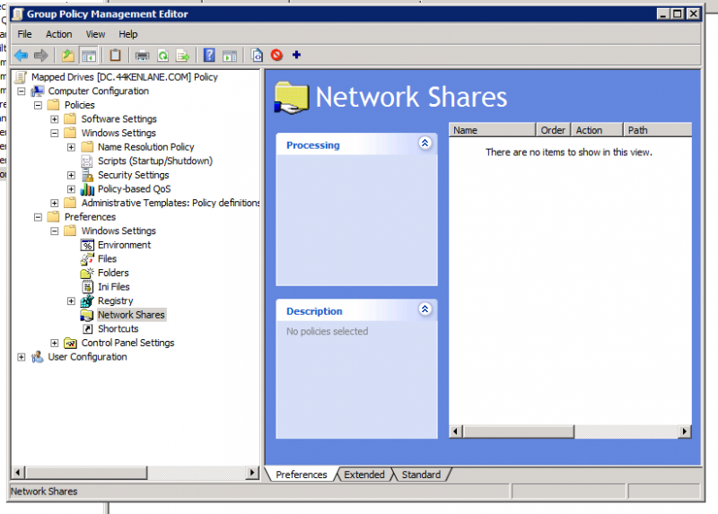

system policy logon script vs user policy logon script. as xendrome is trying to point to.
I'll see if I can find it in the GPOs - Thanks.

Okay, did this:
Created a new OU and moved the Server I need this to happen on to said OU.
Created new Policy based on that OU and defined a Startup Script as follows:
net use Z: \\server\share1
net use X: \\server\share2
net use Y: \\server\share3
[/CODE]
Rebooted Server, nothing happened, service still complains no drives can be found.
