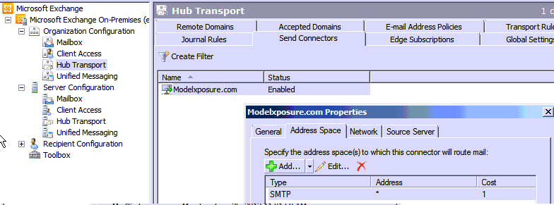

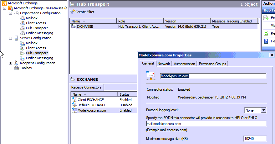

Organization -> Hub Transport -> Send Connectors:

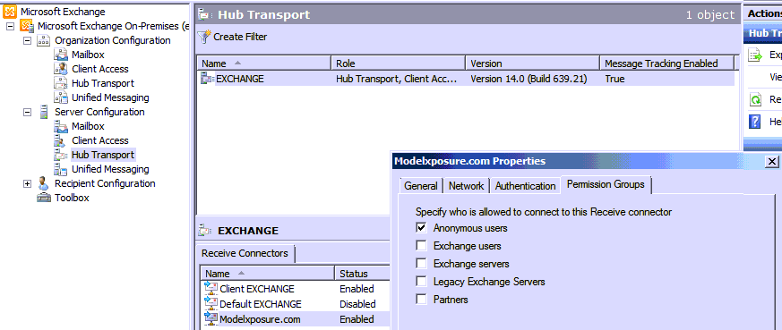

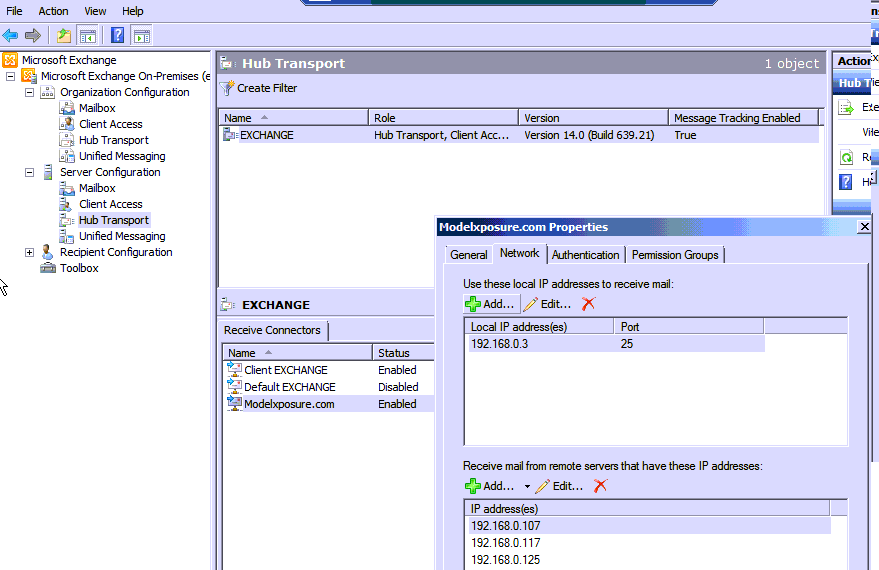

Server Configuration -> Hub Transport -> Receive Connectors:
I would agree with budman that the email address "root" is the problem. You would have to change it with the format of root@something.com. Budmans instructions should do that for you. The receive connector should work for you. The send connector is fine. in exchange 2007 they incorporated a block from unauthenticated sources to send mail outside of the domain.
In exchange powershell (there is no gui check box or setting you can make to enable this):
Get-ReceiveConnector "modelxposure.com" | Add-ADPermission -User "NT AUTHORITY\ANONYMOUS LOGON" -ExtendedRights "ms-Exch-SMTP-Accept-Any-Recipient"

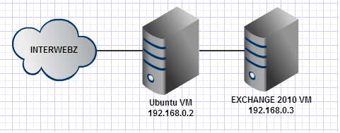

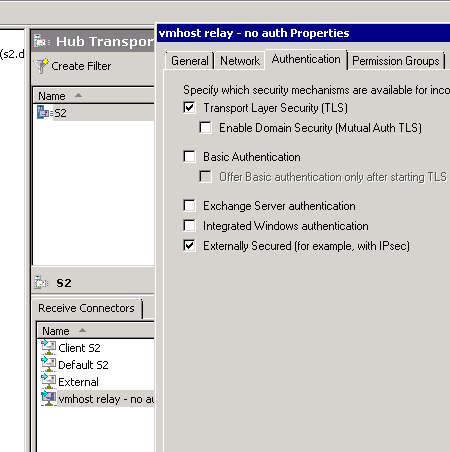

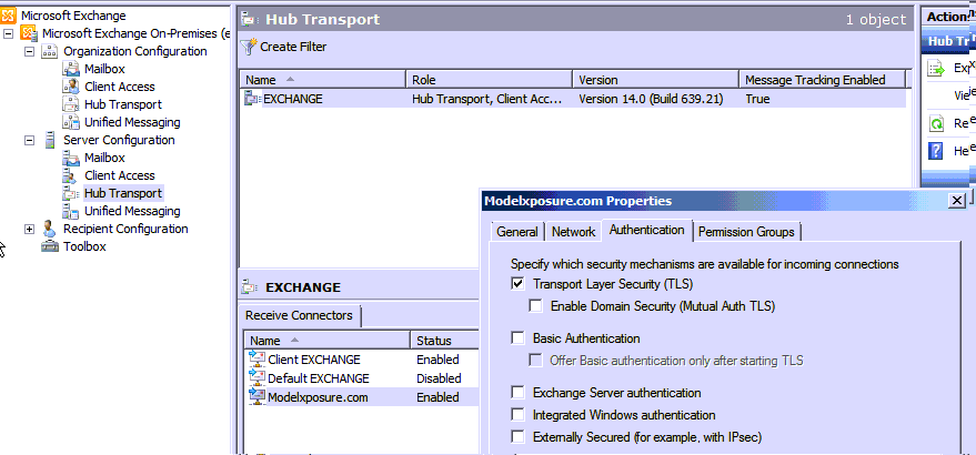

Looking at the initial diagram, your Linux box is 192.168.0.2, but on the receive connector on exchange you don't have that IP listed. Also for an internal machine to send to exchange direct (i.e. not through outlook so not AD secured) then you have to enable 'externally secured (For example with IPsec)' so that the connection will be permitted, as your box sending an email is acting as a client in this scenario and not a relay server.
See screenshot:
Sorry ignore me, this is for relaying through the server, doh!
