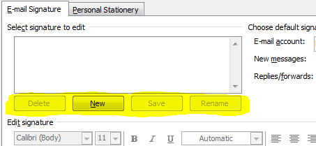

Is there anyway to disable these buttons in outlook via GPO or writing an add-on code like in VSTO / Outlook object model? We don't want to disble the entire form like all the group policies I've seen, we want the user to be able to select their new and reply signatures, but the actual available signatures will be generated for the user via scripts that will pull info from the LDAP provider.
Anyone ever do this before or know what the ID's are for these buttons to disable them via GPO? I found ID's to disable items on the stationery page but not this page...
I'm talking about the highlighted buttons in this picture

You cant as they are stored client side
you can disable all signatures
the response from the MSFT person isn't even correct, you can disable more then just all signatures, we've already done it we just can't get to the point we just disable those buttons, and the fact the signatures are stored locally is a non-issue as we regenerate these files at every start of outlook via our add-on we wrote..

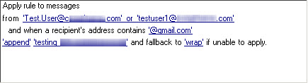

The hub transport can figure out who by mail address or by a what the message header contains or by what the subject line contains. You can set it up by member of distribution list or by individual user.
If you are saying that they need to select their sigs based on what they are doing...what they are doing should have identifiable text either in the body or in the subject which could be used to have the transport change the sig
Here is an example of a by mail address. I just created this and tested against my gmail account...it works just fine.

we know about all that, it still doesn't fit what users and the CEO want therefore it is not an acceptable it... trust me, hub transport rules do not work for our situation we've already spent a lot of time looking into it and trying to find ways to make it work, it in the end does not work for our situation
