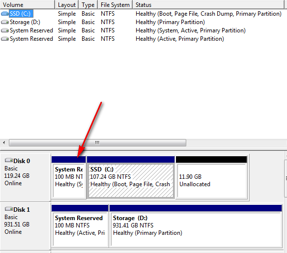

Why would you need more than say 4 partitions on your disk? What OS is this - where is your system reserved 100MB partition?
There're 3 :) out there.. the reserved 100mb I quess it's hidden..
So move your files - and then delete the logical and then the extended. Then I would resize your C to give you some more space.. With 120GB+ of non used space there is no reason for C to be so cramped.. What if you find a couple more programs to install?
Then once C is correct size, then create a new D drive usng the now unallocated space or make it whatever size you want, etc.
It shouldn't be hidden from disk manager - it wouldn't have a drive letter on it -- but you should see it on a normal windows install.. This is What flavor of windows?
Im in the process of moving to SSD, so forget your seeing a second 100MB system reserved partition there on that 1TB drive - that use to be my old system disk.. And have not cleaned it up since fired up the new SSD.. Once I have the new system how I want it.. I will clean up that disk and git rid of the 100MB partition on it, etc.

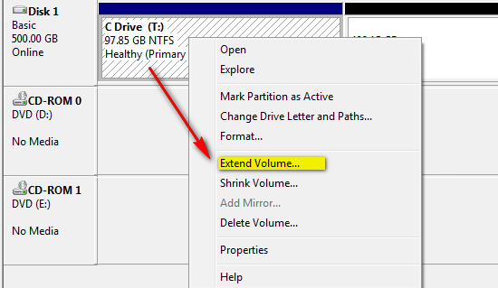

You can resize partitions, os or not, with win vista and above. The issue is there needs to be free space directly next to the c partition it can't be 2 partitions over. You need 3rd party tools for free space not next to the partition you want to resize or to reallocate space from one partition to the other.

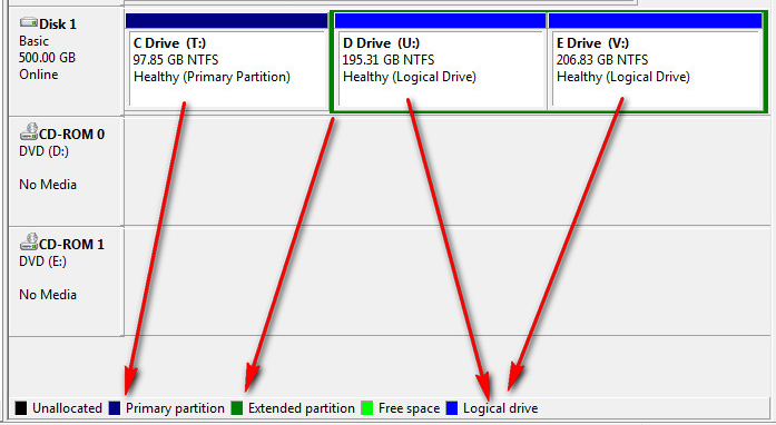

edit1: Ok here is your drive.. Forgot the sizes... You have your C is primary partition, then an extended with 2 logical inside

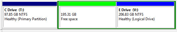

So delete the logical
Then you look like this - again forget my sizes in my example here.. Just that you will have a C drive and then unallocated space
It will then look like this

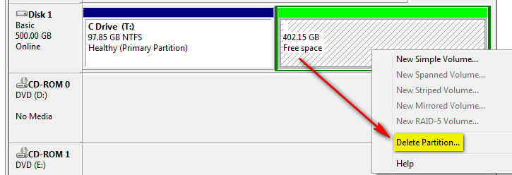

So delete the other logical - you then, you have just freespace in the extended part. Delete the part
You will then have this
  • Like 2
So now you can resize your C if you want to say 40GB, I will change mine to 200GB in my example
Run a wizard - set your total size you want for your new larger primary partition with OS on it
you then end up with this

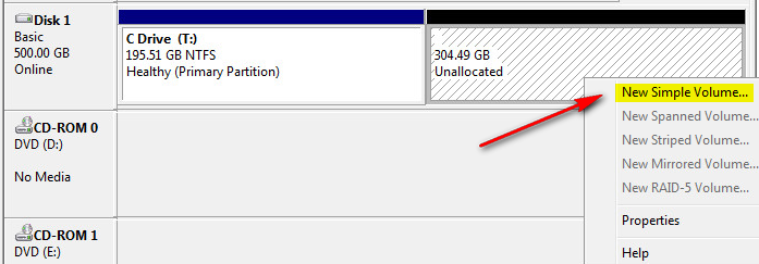

You can then create your new D drive

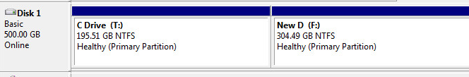

And you end up with this
There is a complete walk through -- if you don't get what you need to do, I don't know how simpler I could show it??
Now just put your files back that you put in a safe place (extenal, file share, DVD, etc) from your old d and e onto your shiny new whatever size you want D drive. No 3rd party software required.
