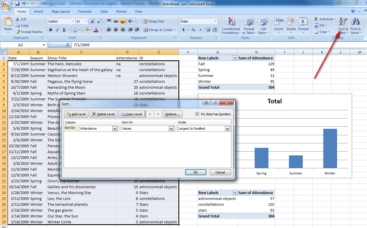

I have this data I would like to chart and I'm not sure what the best way to do it.  What I'm trying to achieve is figure out what shows  (Show title) are most attended (attendance), what season/time of year people most attend the shows (date &/or Season), and what type of shows people most attend (ID).  Im not an expert in excel so Im not sure how I can do this.  Can anyone help?

difficult to grab your data and show you with it just being a pic but simple sort on the attendance column will show you which shows got most attendance.
as to the other things you want to see, you can just create another cell to add up all the winter, fall, etc. attendance. Same goes for types of shows.
If you just post your data in a csv can manipulate it for you and show you exactly how to do it.

Ok - as suggested pivot tables make it easy. So you highlight your range and then insert pivot table or chart
You can then manipulate the table with what you want to see info on, change attributes of say the attendance to sum vs count, etc. etc..
You can click into any pivot table you created to edit, etc.
For you most viewed show just picking the data and then doing a custom sort on the field you want, say attendance to show you which show was most viewed, etc.
Just do a google for pivot tables and should get you started, or just in excel help search pivot tables.
See how I created the one for type of show (ID) - you could do that on show title if you had duplicate titles - but seems all show titles are unique so it would just be a same data.. As you can see the pegasus flying horse had the most - and you can then see the date on the left once you sorted, etc.
Hope that helps.

Thanks.  Hopefully the data will help me show why attendance is down this year.  :)
