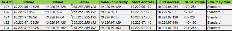

Here is a snippet of the ranges needed:
I'm not so good with Powershell but learning as i go :)
I created one using batch file but i guess powershell is what the boss wanted since it took a while.
However it took a while because i didnt know how to properly import a CSV file and pipe the commands in.
So basically i ended up creating something like this

you can use netsh -f config_dhpc.txt
The text file will contain the following (I did the first 2).  You can do a find and replace to the values, but it wouldn't be a fun task for 100's of scopes to add in...then again you probably wouldnt be adding in this many scopes at one time unless you were trying to do a manual restore either from memory or documentation.  I can't see this being a very easy task.
