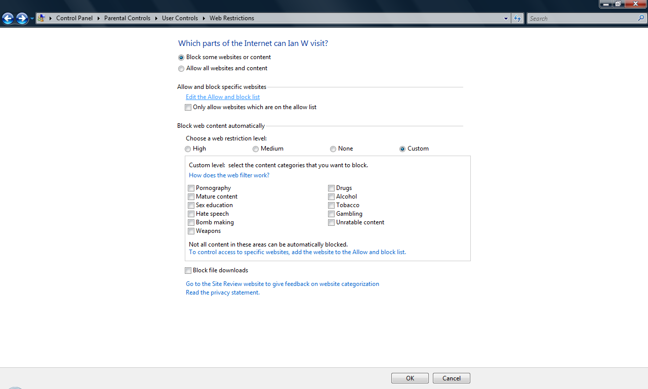

  On 26/02/2015 at 20:06, sc302 said:
It should be noted that only Windows Vista and Windows 8 / Windows 8.1 provide a web filtering feature. If the OP is using Windows 7 then the use of a third-party program is necessary.
The web filtering features in those operating systems are quite extensive. Not only can websites be blocked based on predefined categories, but additional options to block specific websites and/or file downloads are also available.
This is kind of advanced, but it is very awesome.
