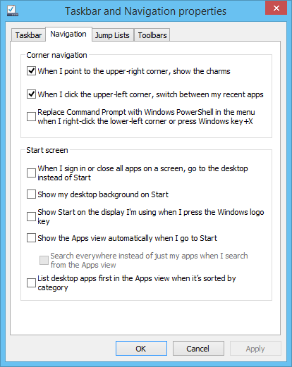

  On 10/04/2015 at 17:19, Max Norris said:
Yea, right click the taskbar and check the properties. Under "Navigation" uncheck the one that says "Go to the desktop instead of Start when I sign in."
Thanks for the reply, but I already had that unchecked under Navigation. I read that 8.1 is set to boot to desktop by default and no option to change it. In version 8
the defailt boot was to Metro Start screen. I was hoping someone had a registry hack to change 8.1 default boot back to metro.

The above posters are correct. Boot to desktop and the related checkbox to turn that off, were only introduced in 8.1
  On 10/04/2015 at 19:02, Ian W said:
Right-click the taskbar, select Properties, click the Navigation tab, and enable the "When I sign in or close all apps on a screen, go to the desktop instead of Start" option.

I left "When I sign in or close all apps on a screen, go to the desktop instead of Start" unchecked.
You must have misunderstood my original post. I don't want to go to the Desktop, I want to boot 8.1 directly to METRO START SCREEN instead.

Right, it is set to go to the desktop by default, but unchecking that box (which I forgot changed its text with the later update) will have it go to the start screen instead as soon as the user logs on, positive about that as I have a few 8.1 systems at home doing that now. I'm not in front of it now to check, but it should be setting the registry key below:
HKCU\Software\Microsoft\Windows\CurrentVersion\Explorer\StartPage\OpenAtLogon
Setting that to 1 has it go to the start screen, 0 is the desktop. That's assuming some third party extension isn't overriding that of course, in which case you need to deal with that.

try to check it,apply,ok, reboot. then uncheck it,apply,ok and reboot, see if this works.

That's exactly what it should do. Maybe Classic She'll screwed with something.

I'm terribly sorry. I didn't misunderstand your original post, but I did apparently get the options confused. If you disable the option I previously mentioned then the OS should boot to the Start screen instead.
