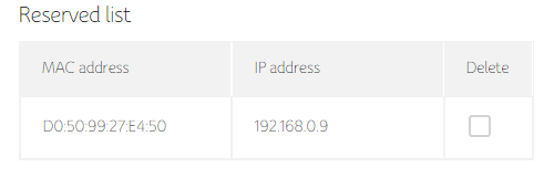

Just a thought, @gregor can you set a "preferred" connection based off the MAC Address?

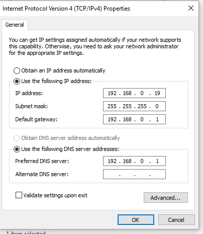

Setting my adapter to static IP didn't help.
Ethernet adapter Ethernet:
   Connection-specific DNS Suffix  . :
   Description . . . . . . . . . . . : Intel(R) Ethernet Connection (2) I218-V
   Physical Address. . . . . . . . . : D0-50-99-27-E4-50
   DHCP Enabled. . . . . . . . . . . : No
   Autoconfiguration Enabled . . . . : Yes
   Link-local IPv6 Address . . . . . : fe80::2c09:7b08:a969:87db%5(Preferred)
   IPv4 Address. . . . . . . . . . . : 192.168.0.19(Preferred)
   Subnet Mask . . . . . . . . . . . : 255.255.255.0
   Default Gateway . . . . . . . . . : 192.168.0.1
   DHCPv6 IAID . . . . . . . . . . . : 47206553
   DHCPv6 Client DUID. . . . . . . . : 00-01-00-01-1D-F4-6F-55-D0-50-99-27-E4-50
   DNS Servers . . . . . . . . . . . : 192.168.0.1
   NetBIOS over Tcpip. . . . . . . . : Enabled
static.thumb.PNG.08edf6797fbf6495ca2c923

@BinaryData
I am going to try to set preferred network in router settings as you said:
reserved.thumb.PNG.afbe45371997033da2cf6
...aaand that didn't helped either.
  On 05/12/2015 at 12:13, gregor said:
@BudMan
@JaLooNz
my adapter doesn't show as unplugged or connected but as "Unidentified network".
@BinaryData
Expand
When you set a static IP, it may show 'Unidentified Network', but could you ping the router?

so when you set a static, and you tried to ping your router..  That doesn't work??  right after you ping look in your arp table.. Do you see the mac of the router??  Do you not see an entry in the arp table.. Do you see invalid mac, or other error in the arp table??
you can view the arp table with arp -a from cmd prompt
please after setting static, show ipconfig /all then ping ip of your router and then arp -a and post the results.
