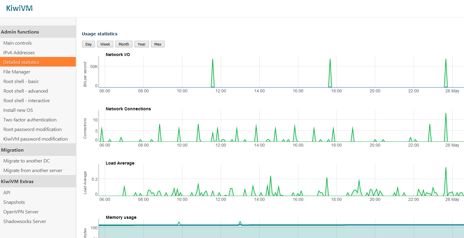

Handle what? You have what a 5$/month vps there?  Pretty sure it can run vnstat ;)
Not sure what kind of fancy pictures you want.. Running real time graph?  They don't provide you with that? Then get a vps somewhere that does.
Is something like this what your looking for? I can send link to company, I have a vps there..

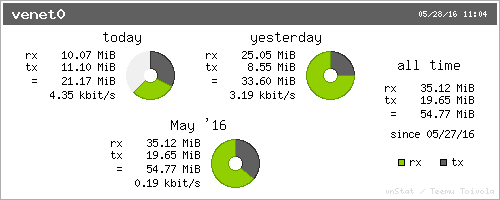

As to getting vnstati to dump a pic
vnstati -s -i eth0 -o /tmp/vnstat.png
Output traffic summary for interface eth0 to file /tmp/vnstat.png.
Really - you can not figure out how to post it to your www dir??
Here just dumped this from the vps I installed it on yesterday
