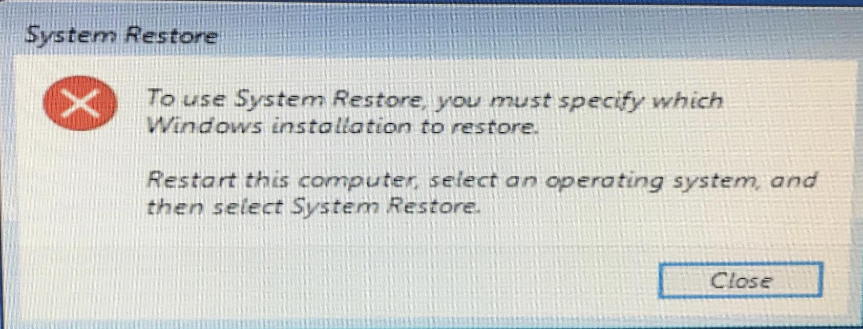

This is not going well. I cloned my old hdd to the SSD using HowTo Geek’s guide here.  I unplugged the old hdd, plugged in the SSD in its place, and I get the first screenshot attached about this pc needing to be repaired because something is missing.
I made that bootable USB as well as a recovery CD. Using either one gives me the second screen. If I choose System Image Recovery it can’t find one. If I choose System Restore, I get the third image. I’m not getting an option to choose an operating system, though, so I don’t know where I’m supposed to go. Using Startup Repair just says that first error again and gives me the option to go back to the second screen or shut down.
Okay, so I googled the error code. I found this on Microsoft’s site and followed the directions. It didn’t find any windows installations. Here is a screenshot (sorry it’s on imgur, I ran out of upload space for images.)
Next I googled about why it can’t find any installations and found this on Microsoft again which said I needed to run bcdedit. Resulted in The store export operation has failed - the requested system device cannot be found.  (That second link is another screenshot.)
Back to The Google, it seems this happens when Windows can’t recognize the USB port. I have 4 ports on my PC, 2 are USB 2.0 and 2 are USB 3.0. I tried juggling them all around and still get the same error. At that same link it suggested my drive was registered to another letter. I remembered when I’d plugged it in before it was listed as G. But I tried the command on that page -
bcdboot.exe G:\Windows /s C:
and all I got was “Failure when attempting to copy boot files.” Just for good measure I tried subbing in drive letters C, D, E, and F too. Same error.
And here we are. I’m at a loss. What do I try next?

The problem is I’m not getting any option to do a clean installation of Windows. I just get those blue screens I posted above.
I temporarily have all 3 drives (HDD, SSD, media drive) plugged in, at the cost of losing my DVD-ROM (not enough power cables to go around.) I was going to try re-cloning the drives. I can unplug the HDD and media drive and do as you suggested but I’m not sure I’ll get anything different.
Welp, I guess I completely broke it. I was certain it was still booting off the larger hdd because this morning, I temporarily put some files on the hdd, that would not have fit on the ssd, while I converted my media drive from MBR to GPT. The computer booted fine after that. So I formatted the ssd on order to clone the drive again. And then restarted. Now it won’t boot at all. It won’t boot off the hdd with the ssd disconnected. It won’t boot off the ssd with the hdd disconnected. It won’t boot with both drives connected.  It won’t boot from the USB recovery drive. It just hangs at Loading Operating System. Pressing F8 does nothing.

My friend, that’s what I spent all day yesterday trying to do. It wouldn’t give me any kind of option to do a clean install. I tried using a USB drive and a CD.  It only wanted me to do a system restore but then couldn’t find a restore point. And then today it just completely stopped booting. It wouldn’t boot off either drive nor would it boot from the recovery media.
I gave up in frustration and took it to a local repair shop. I have never had any kind of problem like this before and I’ve replaced several hdds with ssds (6 by my count). But all in laptops, never in a desktop. Not that that should have made any difference.

Sounds to me like it's not booting into the installation media but instead into the recovery of the old install.
  • Like 2
Expand
This, check boot order in BIOS, make sure you have CD or USB before the HDD/SSD
Or, in most systems F8 should get you to a boot menu and select the correct option

I did choose to make it boot from the USB drive and the CD (I tried both options) and still got taken to the same non-functional error screen. (F12 in my case.) It’s a moot point now as I dropped it off at the repair shop. I spent two days troubleshooting it. I’ve cloned and swapped drives before and never had any problems so I don’t know what went wrong this time.

The repair shop called. They said they tried every boot sector repair tool they had and none worked. They’re going to wipe the SSD for me and reinstall Windows. So it wasn’t just me.
