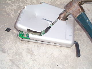

If all else fails, you might want to try this: (That's my old MN-500 Wireless Access Point).
I don't know why this is so "cool" :rolleyes: It's a perfectly good piece of hardware, sell it if you don't want it. You're just wasting money by destroying it (N)
Maybe I should clarify on that issue. The Router kept resetting itself every few hours for about a month, until it finally died. I called Microsoft Tech Support and they said I had to send it in to have it replaced. Since that process was going to take a few days I decided to buy a new one on that same day (Not a Microsoft one, but still a Wireless Router). So I got to keep a dead WiFi Router until I decided to smash it with a hammer, lol. :laugh:
But no, that was not a "perfectly good piece of hardware". :p
