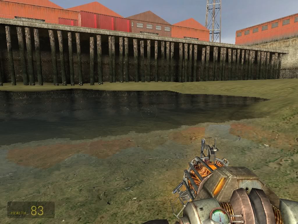

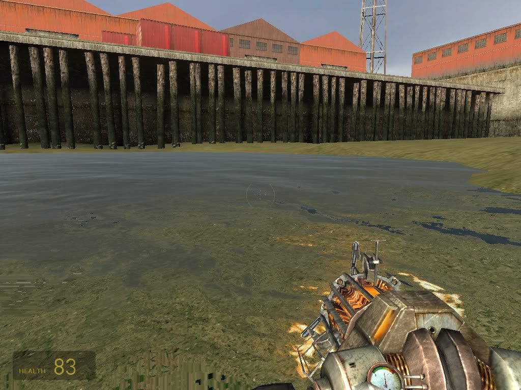

  PukiMan said:
I really don't see the difference
without -dxlevel 90:
with -dxlevel 90:
Are you sure HL2 don't use DX9 on default?
And in the process of taking the screenshots, I learned those things (The flying bugs that come from the ground) can't swim :D
584968498[/snapback]
I guess that's 2 times dx9, did you add -dxlevel 81 to go back to directx 8.1?
I've put it on 8.1 to test and it looks different
584968869[/snapback]
-dxlevel 81:
-dxlevel 80:
Nothing, no difference at all.
Tryed to do the command in the console and is said thats the command in incorrect.
I think the command is wrong.
You have to do it via Steam's Launch Options.....
Open Steam, click on Play Games, Right click on the game and click Properties, then click on Launch Options and add -dxlevel 81 or -dxlevel 80...
There IS a difference...in Dx81 u will NOT get reflections on water....i will go do a couple of screens :p
