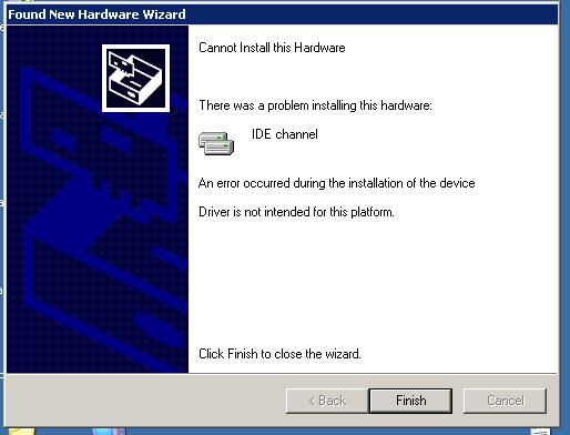

hi there i am hoping someone will be able to help with my problem
i have just installed a new motherboard an ASRock K7S41 and everytime i boot up i get a warning asking me to install an IDE Driver from the windows XP Pro Service Pack 2CD, the file is called ATAPI.sys, but there isnt a file called that on the CD, i tryed installing that file from the Cad file in System32/driverss directory and that didnt work, any help would be aprriciated

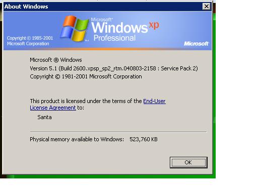

Hmm, seems like you're trying to install incompatible drivers, maybe drivers for another version of windows? It says driver is not intended for this platform. As far as I can see from the screenshot, it looks like you're using WinXP with disabled themes service, or is it another OS?
Can you run "winver" and get a screenshot?
By the way, I can't find any relevant driver here: http://www.asrock.com/support/Download/dl_k7s41.htm
The right driver should be called IDE driver or bus master driver, or ATA driver, something like that.
Check this site:
http://www.majorgeeks.com/download4401.html
Download the file, install it, and STEP4: "Execute ata133.exe for IDE to let IDE support UDMA 133 (XP)"
If this doesn't work...
Can you try this driver directly from Sis? http://www.sis.com/download/download_step2...9&Image7911.y=7
I don't know if it's good for your chipset, so this should be your last resort. It says SiSM741 abd your chipset is SiS741, it might break your installation if it's not compatible.
Yup, this version is the final version of SP2. Hmm, you did execute ata133.exe and you still have the problem? I'm clueless.
Some guys are having problems with non-genuine versions of windows, or with genuine but user-made slipstream versions. Try someone else's XP cd-rom to install windows XP (use your own cd-key, the one you already used)
