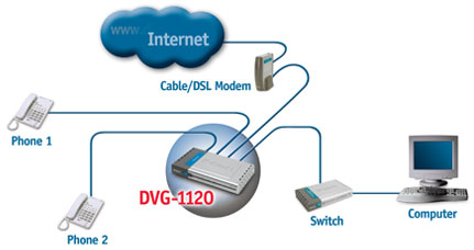

the voip modem is a D-Link DVG-1120. It comes with its own firewall and such. It has a WAN connection and a LAN connection (both ethernet). I use the WAN connection in order for Voip to work in my current configuration. The lan is really for any other computer to connect to that particularly modem. (so WAN = uplink, LAN = regular port).
After this long explanation of how I have things setup, is it possible to access 192.168.15.1 through my current configuration (through my router)? Do I need to setup IP forwarding? Or is it something else that I need to do?

Um dude that D-Link DVG-1120 is a home Gateway device or router.. You really have NO use for 2 routers.. The DVG-1120 can plug right into your broadband modem..
You could just use the switch portion of your other router.. But currently your double natting.. ie your other router has a public IP address on its WAN, than the 10.x.x.x network on the lan side.. your VOIP gateway/router has a 10.x on its wan..
Your setup is more convoluted then it needs or should be.. I suggest you go over the documentations of your products -- here is a link to the manual for your 1120 ftp://ftp.dlink.com/VoIP/dvg1120M/Manual/..._manual_110.zip
From a quick look - you can set a manual IP on the WAN side of that 1120, change it to work in your 10 network.. And then you should be able to access its controls from this wan port.. You may need to enable that feature, etc.. RTFM
You really have NO need for the other router.. your VOIP router looks like it provides most all the functions you would need in a SOHO router.. What features of the other router are you looking for -- that your VOIP router does not already provide?
