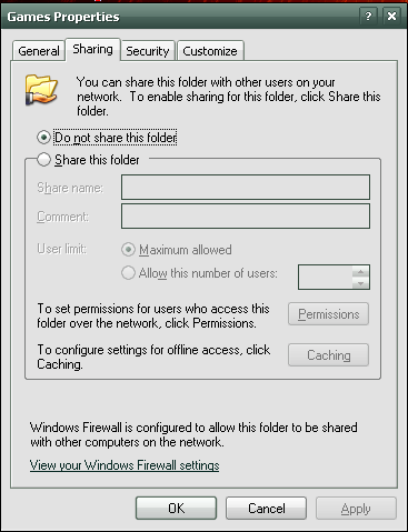

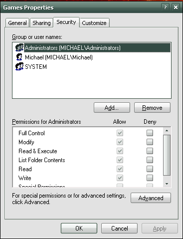

The reason I turned off simple file sharing is because it enables this tab:
It also creates a more advanced Sharing tab:
I don't want to lose these things by going back to simple file sharing, so I want to know if anybody has a solution.

When I have simple file sharing enabled, it doesn't ask to login, it just lets them through and shows a list of all the shared folders on my PC. This is the behavior I want, but I want the advanced file sharing features to go with it (those in the screenshots above).
