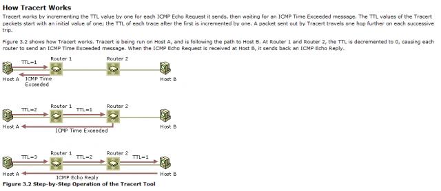

Tracert
Tracert is a route tracing utility that display a list of near-side router interfaces of the routers along the path between a source host and a destination. Tracert uses the IP TTL field in ICMP Echo Requests and ICMP Time Exceeded messages to determine the path from a source to a destination through an IP internetwork.
If your router is not sending anything back, or blocks icmp -- I could see why the the command would choke.. Or if you have a firewall blocking net access to tracert.exe but allows ping.exe -- then that could cause you issues.

Is your router not reducing the ttl value? Or do you have a software firewall that could be blocking tracert.exe? Its possible to have your router modify the ttl values to get by some tricks some ISPs do to prevent you from using a NAT router to your connection, etc..
  Yorak said:
Nah the router isn't reducing the TTL value. I just use the firewall on the router combined with Windows Firewall, which doesn't have it blocked.
Um all routers should reduce the TTL value. I thought you said you understood how traceroute works? ;)
If yours is not, then that could be your issue - if your router is blocking ICMP or not sending out Time Exceeded messages, then this could be your issue.. Or if your firewall is blocking you from recv this info.
