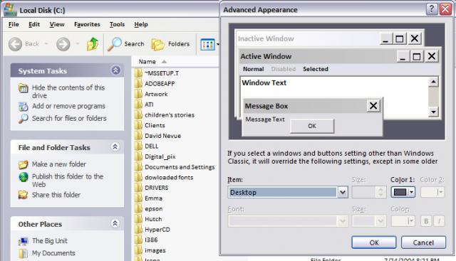

Ihave attached a screen shot showing the mix of fonts. Notice Tahoma still showing up on the left-hand links menu. The other image shows the advanced appearance window...notice that Segoe UI shows up here.

Yes, I am a aware of the advanced appearance settings...I changed those long ago. It was only after that when I noticed Tahoma was still present. I changed every possible font in advanced appearance, plus the fonts in MS Shell Dlg & MS Shell Dlg2. Tahoma is still everywhere (see screen shot above). So obviously there is still some hidden location that insists on Tahoma being applied to certain system windows, etc.
