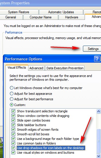

As to your issue icon text not going back to transparent - an you do not have any type of webpage or active desktop running.. Check that you have this flag set.

Funny, deactivating Active Desktop leaded me to nothing, but changing the font blend (not to ClearType mode) worked.
Problems solved, thanks
