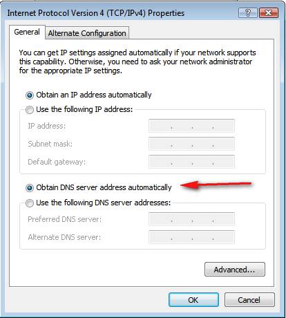

Well then post your ipconfigs.. Since it makes no sense that your vista machine is getting an dhcp IP address, but not the dns settings?
Unless of course the machine was set to use dhcp for the IP, but had manually set dns to something else, say opendns or something?
So yes to get the machine to use the dns handed out by dhcp, it has to be set to use dns from the dhcp server, which is the default.
