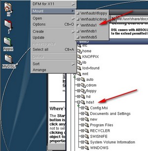

Did you not read any of the documentation? Your going to have to mount what partition you want to share/access, rightclick on the screen an pick mount.

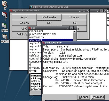

If you then want to share a mounted partition out to the windows world -- your going to have to install the server side of Samba -- from the mydsl applications -- pick net, there is the samba server
