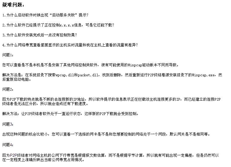

But I did extract the contents.. Can not make heads are talls of the help file. But with the wpcap.dll an wanpacket and packet.dlls an a exe called "arp"over.exe. An there is a screen in the help asking something about a switch or hub.
An this screen from the help
Which would seem to be your adding some IP address to the machine running the software, with specific macs
I would guess that what its doing is acting as the gateway to the other machines on the network.. Like I said if you are the gateway off the network then you can control bandwidth no problem..
So either your setting the other machines to use your box running this software as the gateway -- or your tricking them into using you as the gateway.. This can be done with a simple arp spoof..

My chinese is terrible. Even worse is my translation. Sorry about that. I think i got most of it. Anyways here is how it goes
