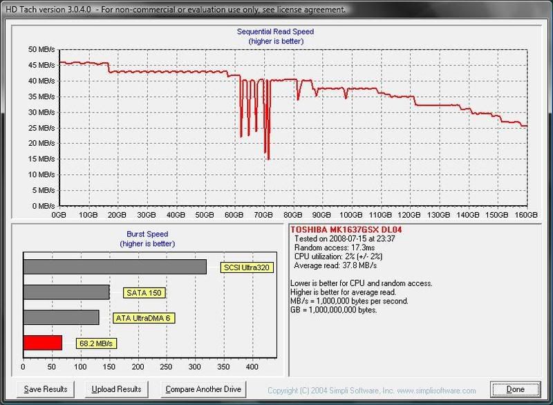

For what it's worth, here are HD Tach Extended Test results (ran in XP SP2 compatibility mode):
Seems hella slow to me, though it may just be a result of running compatibility mode, or the fact that I've been adding/deleting GBs of files over the past day without a defrag (current freespace on disk is ~13GB, was <1GB about 24 hours ago before I moved some files over to an external).
EDIT: My bad, but perhaps notebook HDDs are supposed to be this slow. If so, disregard the HD Tach info. Was just trying to use it as evidence for a potentially failing HDD.
