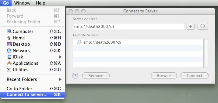

but now that im in front of my laptop i can do the SS of what its suposed to look like
just change the death2000 to whatever the other computers name is, the C$ is the directory you want to connect to ( should not need it )
