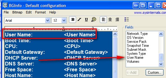

And the builtin UserName is not working?
why do you think you need to do a wmi query, when it has a builtin username you just click add on.
edit: Ah -- you want to pull the "fullname" just the account name. I'll take a look see.
