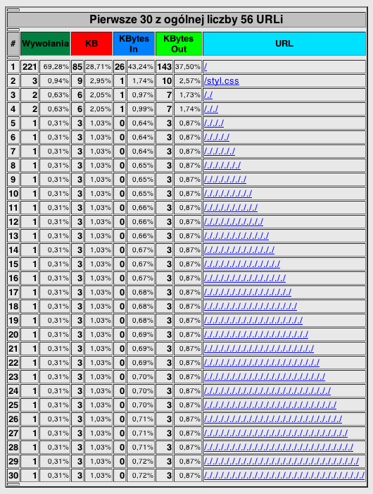

I have a question concerning .htaccess and regular expressions. In the .htaccess file of one of my websites, I pasted the following code to always display "www." in the site's URL:
RewriteEngine on
RewriteCond %{HTTP_HOST} ^info-projekt\.com$ [NC]
RewriteRule (.*) http://www.info-projekt.com/$1 [R=301,L]
I found the code on some website with .htaccess tips. I don't know a thing about regular expressions, so I can't tell if it's valid.
The reason I'm posting this is that my page's statistics indicate a problem (see attachment). I suspect the .htaccess rewrite may be the cause of this problem (I don't have any other suspects). If any of you could tell me if the code is correct or what else might be causing the "./" loop, I'd be extremely grateful!
