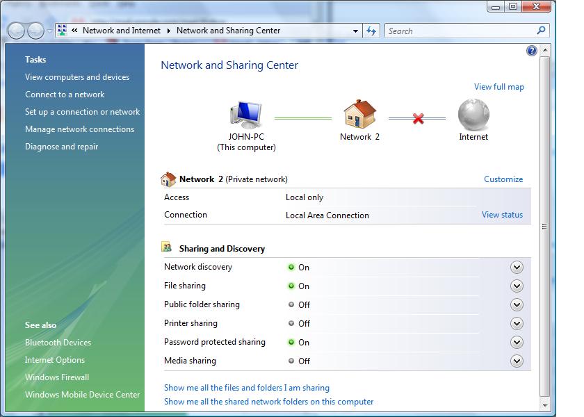

Thanks for the suggestion. Although now I have a different reason to remove the switch.
Since I got FiOS that keeps happening for some reason. To fix it I have to cmd -> ipconfig /release then /renew. But it seems to only be a temp fix since it just comes back at random.
Dunno if its because of the FiOS supplied router or maybe my network equipment. =/
Well if your switch was in place with your old router, highly unlikely its the cause. But sure I guess there could some very weird compatibility issue between the router and your switch that would cause issues with your dhcp renew?? How do you feel that /release /renew is fixing the issue? Are you getting a differen IP.. Did you loose your IP?
If your loosing your lease I highly doubt its random -- look at ipconfig /all once you do a renew -- what is the time of the dhcp lease?? If the client can not renew once that expires then sure your going to have connectivity issues ;)
If its a dhcp issue -- either run a different dhcp server on your network, or setup static IPs on the devices, etc. Or as you suggested pull out the switch and see if that fixes the problem.
I see your running vista, and a new router -- vista has a known issue with some dhcp servers (routers).
http://support.microsoft.com/kb/928233
Windows Vista cannot obtain an IP address from certain routers or from certain non-Microsoft DHCP servers
You could also try disable IPv6 -- some routers have issues with that, and could be causing you problems looking for a IPv6 dhcp, etc. If your not using it, I would suggest you disable it. Google disable IPv6 vista
