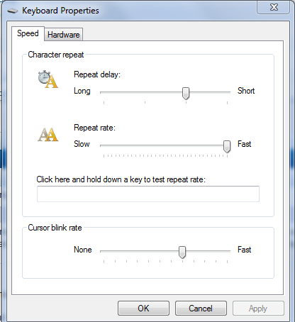

Sounds like the keyboard buffer is getting overloaded, or it could possibly be related to the fact that it is communicating via a wireless signal to the computer, you might just be getting a few ms of lag between the keyboard and the wireless receiver. You could try going to the control panel and choosing keyboard:
Try adjusting the delay and see if that makes any difference, also have you tried to replicate this problem using a wired keyboard?
